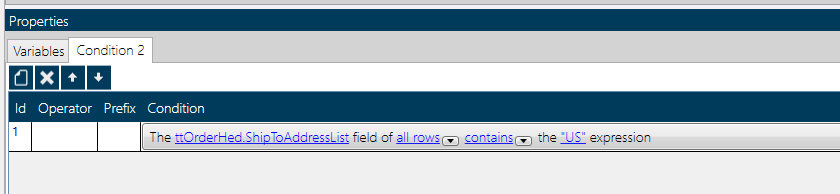

Thank you for the response. I’ve only been working with Epicor for a month or so and have gone through a lot of the embedded and online courses, but even that material doesn’t cover everything. I’ve been working on this off and on for the past few days. The first part of your reply is not an issue, but the second part has me stumped. For my company, we will never ship to multiple locations that would mix domestic and international. That being said, I’ve setup a BPM on the SalesOrder Update method, under Pre-processing where I have a condition that checks if the OrderHed ShipToAddressList field contains “US”. If it does then the OrderNum is set to a variable, and the flow passes to a Custom Code action (see code below). In this action it should go through each record with the OrderNum saved in the variable then change the ProdCode field, which in this case is just TESTING until I can get it to work.

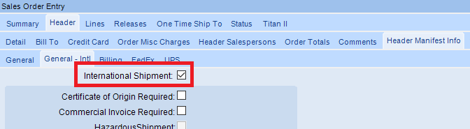

Use a BPM In-Transaction Data Directive on the OrderHed table Condition on the value of the OrderHed.IntrntlShip field (True or False) and execute the following Custom Code:
/* ProdCode */
Erp.Tables.OrderDtl OrderDtl;
foreach (var ttOrderHedRow in ttOrderHed)
    foreach (var OrderDtl_iterator in (from OrderDtl_Row in Db.OrderDtl
                                       where OrderDtl_Row.Company == ttOrderHedRow.Company && OrderDtl_Row.OrderNum == ttOrderHedRow.OrderNum
                                       select OrderDtl_Row))
        OrderDtl = OrderDtl_iterator;
        OrderDtl.ProdCode = "TESTING";

I finally got it, I think! I ended up using a Condition that checked the ShipToAdressList custom field of “all rows”, and then moved to the custom code. Everything seems to be working. Thank you all for your time & help!

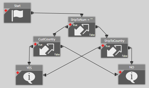

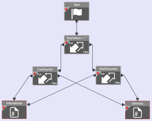

I see an issue if an international customer contains “US” anywhere in their name, city, state or address.

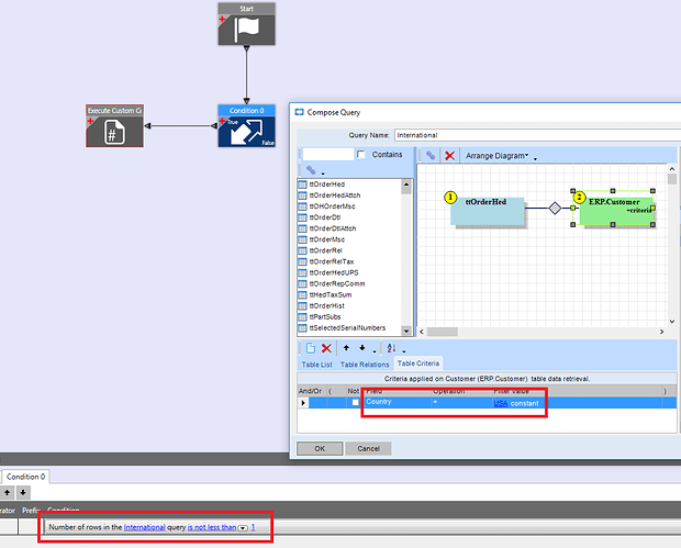

Consider the following:
Check if the OrderHed.ShipToNum = “”
if true check if the Customer.Country = “US”
if false check if the ShipTo.Country = “US”
Run custom code to change ProdCode based on either International or Domestic shipping

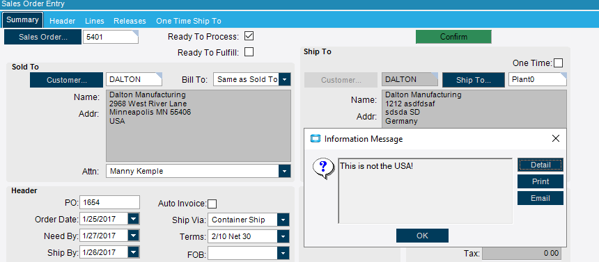

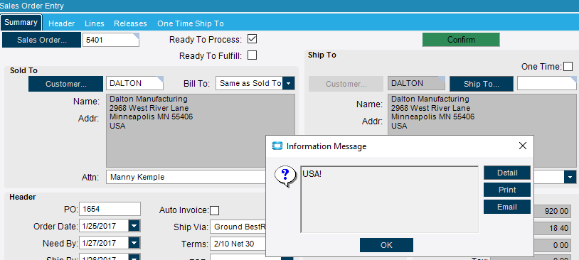

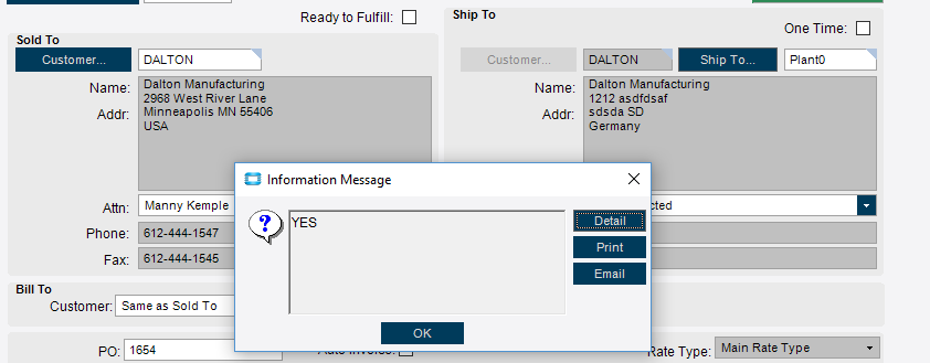

I set it up as you showed, with simple messages to say YES if it’s USA and NO if it’s not…
When I change the ship-to address to Germany and save the record, it still gives me the message of YES…
Thanks for the suggestion though!

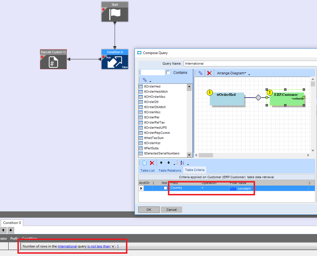

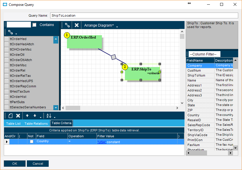

Based on the logic I presented, count(ShipTo.Country = “USA”) < 1 would be true and result in Yes as you have shown. Unless you used Count(ShipTo.Country = “USA”) !< 1 in the query statement
I have it setup as you showed, with the Count(ShipTo.Country = “USA”) < 1. When I change the ship to address between domestic and international and save it gives me the correct response. Perfect!

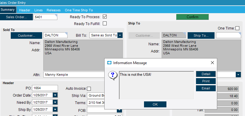

But, when I change something on a line item, say the product group, and then save it fails…
Are you setting up multiple BPMs, one checking for change in the ShipTo and one looking for change in the OrderDtl? If so, verify the logic for determining the country is consistent.
