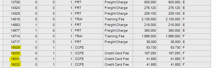

When i run a BAQ of the QuoteMsc table, there is a charge there. I noticed that the QtyNum is 1 for all of the entries I’ve made using the BPM. However, I have specifically set that field to be 0, since I see all the “real” entries have 0 for the QtyNum. Something is forcing my value to 1. Could this be related?

I have tweaked everything but I keep getting the same result. The charge shows up there temporarily, but then deletes itself when I refresh the Quote. The charge does show up when i do a BAQ of the QuoteMsc table but as we discussed, the QtyNum is 1 no matter what I try. And it certainly seems like this is not what we want.
@hkeric.wci - you had good feedback on the Order side. Any ideas on this? I get the Misc Charge to populate on the QuoteHed but it doesn’t stay there. I hit refresh and it disappears. A BAQ of the QuoteMsc table reveals that the charge is there but it has a 1 in the QtyNum field - even though I am trying to get it to enter with a 0 (just like it would if I entered the charge through the UI). We were thinking that might be causing some glitch in the matrix because the quote doesn’t want to recognize that as a valid charge. Any ideas?
