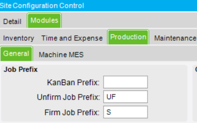

I’m looking to create a BPM to change the job prefix depending on the part’s reference category.
Right now, our MRP jobs prefix is “UF” and the regular jobs are set to “S” for now.
My condition is that, if the part is a new part (NPI), then when firming UF jobs, it would have “N” as a prefix plus the next job seq. For example N00010.
Similarly, if the part is a regular part, then when firming UF jobs, it would have “S” as a prefix plus the next job seq. For example S00011.

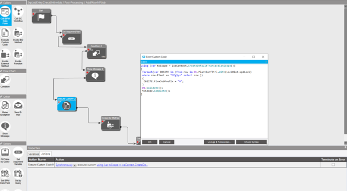

I’m halfway there with my process. I created a post-processing for JobEntry.CheckUnfirmJob. I also did get the conditioning part down (checking the part’s status). However, I got stuck on changing the prefix part. I managed “solved” the issue by updating the Site Configuration field every time this BPM runs but I think this is a bad idea. Anyone else might have a better suggestion or any pointers?
