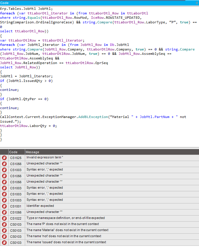

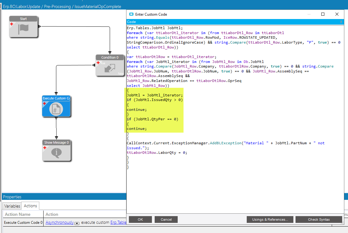

Hi there, not sure if this got resolved but what is the full code for checking that material is issued to the job.
would it be possible for you to share the full code for this?
I think this is what I had mocked up out of our routine. It validates, but has not been tested. Our final audit is FINAUD, so that was easiest for me to check. If you have various final operations, then you will need to check JobAsmbl for the final op number.
Alert on not enough material issued.p (1.4 KB)
