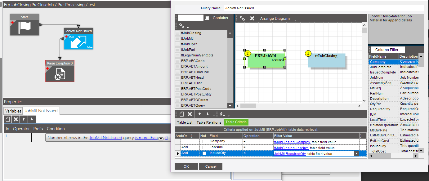

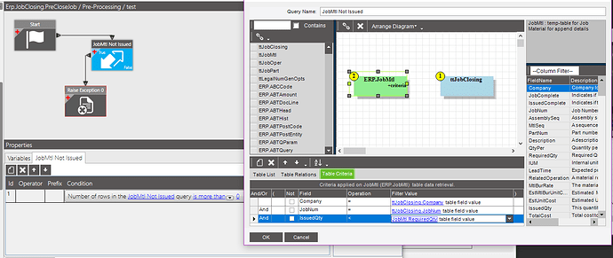

Try
Pre Proc → JobClosing → PreCloseJob
Have a condition where you check ttJobClosing with JobMtl and make sure IssuedQty isn’t less than JobMtl.RequiredQty raise an expection if it is…
I saw somthing to this yesterday and had no luck, the only think i could not replicate is the 2nd table, mine starts with ds. not tt, could this be the problem?

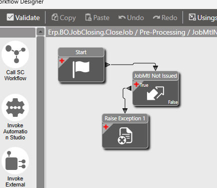

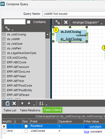

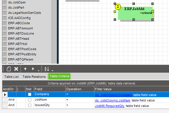

Do it on
Pre Proc → CloseJob
Make a query condition with.
then
then
Raise exeception…
Let me know how you get on…
Amazing! It works, Thank you very much. Incidentally I tried something similar and instead of putting true I had TRUE which gave me an CS0103 error. But it seems to work perfectly.
