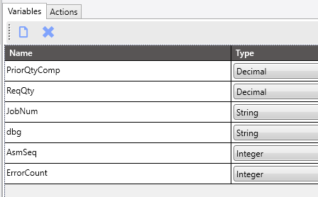

In a pre-proc for Labor.DefaultLaborQty():
  1. Create the following variables:
  2. Add the widgets as shown:
