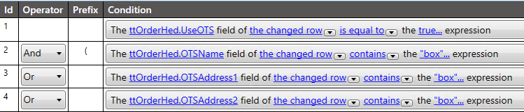

I am working on a BPM to search for ShipTo addresses with PO Box entries. This commonly happens when we enter a new customer and the billing address is a PO box but we have not defined a default Ship To address. If our salespeople do not double-check, they may end up shipping a package to a PO Box, which gets rejected.
I am currently using a Pre-processing directive on Erp.SalesOrder.MasterUpdate with two conditions. The second condition is working, which looks for the OTS flag and checks the OTS fields with a simple “contains” expression:
My issue is trying to trigger the BPM when there is no OTS flag set. I am currently using a query to tie in the ShipTo table as such:
and here are my table relations
Can anyone offer advise as to why this does not appear to trigger when the word “box” appears in the address fields?
