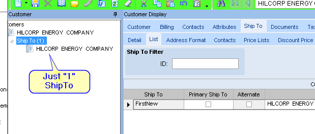

When a new customer is created, a single ShipTo record is also created. The ShipToNum of this record is null. Changes to the Customer record will be reflected in the this ShipTo record.
Adding a ShipTo in Customer entry will create another ShipTo record, but this one will have a non-null ShipToNum. The ShipTo tab in Customer entry will always show one less record than actually exists for this customer.
While a Query of the ShipTo table for this Customer shows:
So there is one ShipTo Record that gets updated with changes to the Customer record. The record where
ShipTo.CustomerNum = CustomerNum AND ShipTo.ShipToNum = ''
Don’t get fooled by the Customer.ShipToNum field. It is used to determine which ShipTo is to be used as the Primary shipto for the customer.

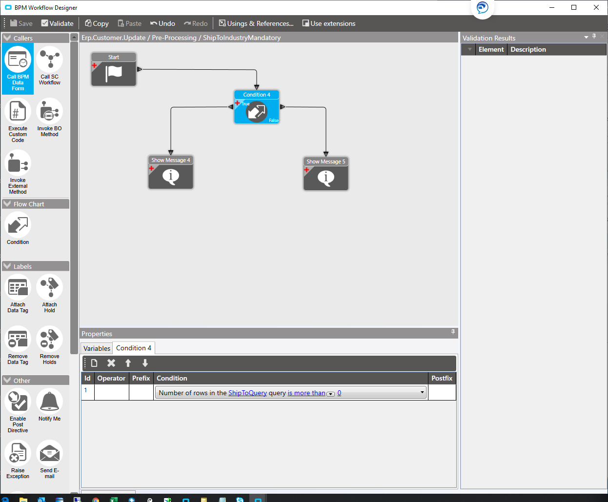

here is my bpm

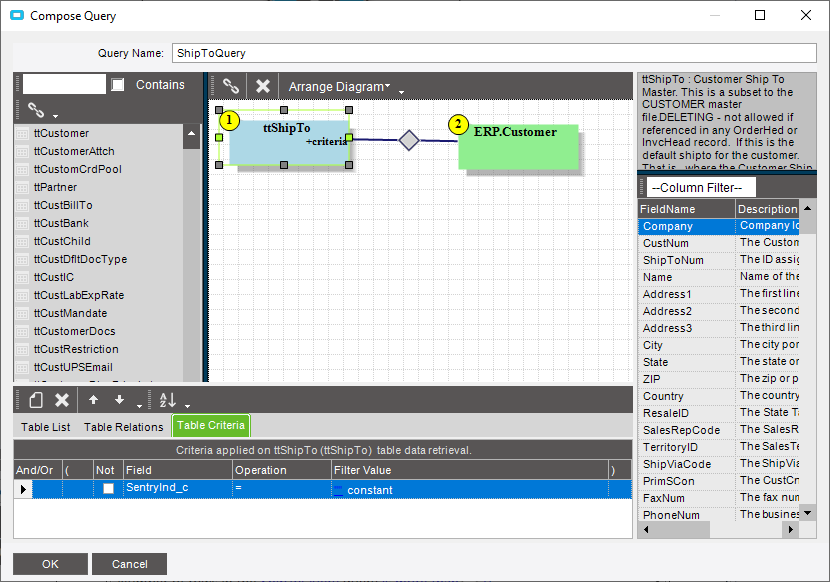

here is my Query
here is my joins in the query
this always keeps going to false side
Remove table relationship between ttShipTo.ShipToNum and Customer.ShipToNum

This “base” ShipTo record doesn’t show in the ShipTo sheet on the Customer Entry form.

The ttShipTo.ShipToNum = Customer.ShipToNum table relationship in the Conditions query, means it will only check one of the ShipTo’s. And most likely the one with the “null” ShipToNum (unles you set one of the others as the Primary ShipTo)
is there a way to return the value of the current ship to im working with.
The ttShipTo should have only the record of the ShipTo that you’re working on. To test, insert a table query into one of your display message widgets, and set it to show the ttShipTo.ShipToNum of the record being updated.

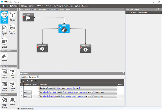

so this is how I got it to work. Screen shot coming.
Thanks for you help.
