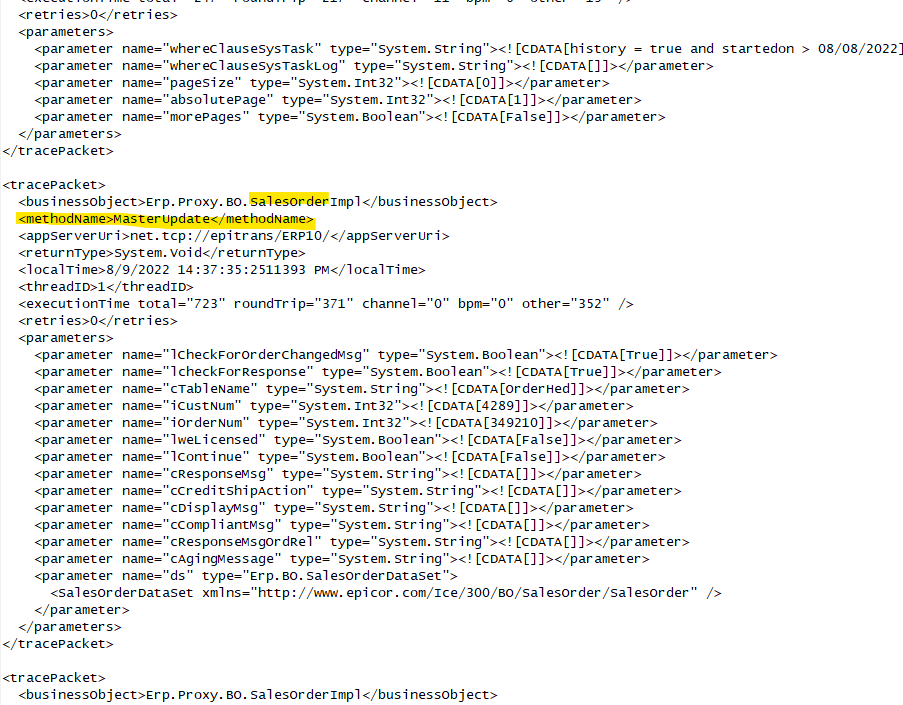

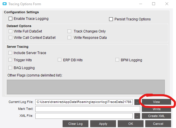

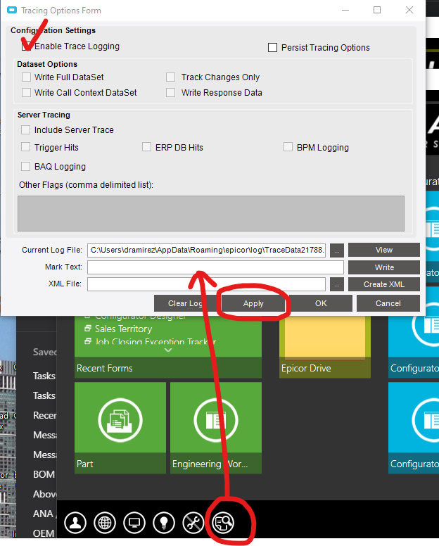

@lbradbury To figure out the correct method to use, you would turn your user tracing on and then run through the UI as you expect the user to do. Once you have saved in the UI, go back to user tracing and view the trace log. This will list out the methods that were called during that interaction. If you’re entering an order, you’d see something like SalesOrder.Update or SalesOrder.MasterUpdate depending on what was entered/updated.
Remember, MasterUpdate runs multiple times (twice?) … so when lContinue == true you’re on your second trip through the BO.
I say that because sometimes what you’re looking for doesn’t happen until the second trip.

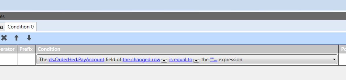

Thank you everyone, I have learned so much from your repsonses! I believeI have created the method correctly, but when the field does have data in it I still recieve the message. So I must not have done it corectly.
Can you show us the condition in a snip?
@lbradbury I would think that would work, but try using string.Empty to see if that works. Or change the changed to Updated.
That’s a good point. Changed means added or updated rows, I believe.
I didn’t know that! It explains so much about previous struggles, though. So would you set that in a condition when you want it to execute during the second trip through?
Yes, using it in a condition would affect when you did your actions.
