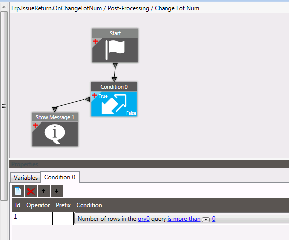

I made a Post-Processing Method Directive on IssueReturn.OnChangeLotNum
Condition qry0 is

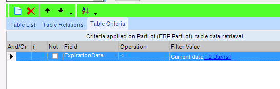

and Table criteria for ERP.PartLot is:
(I set the “+2 days” just for my testing as the one lot I created expires tomorrow)

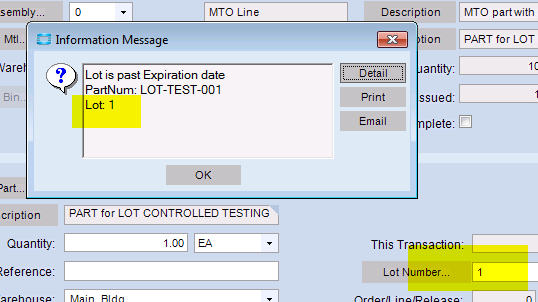

When in the Material Issue screen, and I set the Lot to 1 (and then tab out of the field), I get:
If I choose lot 2 and tab out, I don’t get the message.

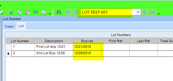

BTW here’s the lots for that part:
EDIT:
Note that this only checks the expiration date, when the lot selected changes. And it does nothing to top the issue from happening. To keep from selecting a lot past its expiration date, change the “Show Message” widget to a “Raise Exception” one.
And probably best to make the condition compare the Expiration Date to the Issue date, instead of to Today’s date. That would allow you to process an issue the happened yesterday, for a lot that expired today.
