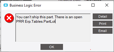

I am trying to write a BPM to see if a field is checked off on the part lot table for the lot being shipped. I have gotten the code to pass the syntax test but it shows the error pop up each time, even when the box isn’t checked.
string MSG = string.Empty;
Erp.Tables.PartLot PartLot;
var ShipDtlRow = ttShipDtl.FirstOrDefault();
PartLot = (from pl in Db.PartLot.With(LockHint.UpdLock) where pl.Company == ShipDtlRow.Company && pl.PartNum == ShipDtlRow.PartNum && pl.LotNum == ShipDtlRow.LotNum select pl).FirstOrDefault();
if(PartLot.OpenPRR_c == true)
  MSG = "You can't ship this part. There is an open PRR";
    CallContext.Current.ExceptionManager.AddBLException(MSG);

I added the info after my message. Not what I was expecting…
@MelissaC Here are some screenshots of a simulation I did of your bpm. The hardest thing about what you are wanting is that the check on getbyid has to be post processing so an exception won’t stop anything there. You can do a message but not likely a stoppage of processing. Assuming you use QuickShip you can stop the transaction in ChangeStatus when the pack is being closed. If they can’t close the pack then they can’t freight it.
