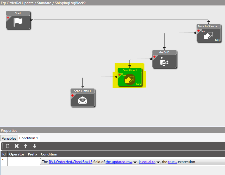

I was asked to write a BPM that said If Orderhed.Checkbox15 = True, then do not allow OrderRel.Custom1, OrderRel.Custom2, OrderRel.Custom3 be changed. Throw an error message and terminate and don’t save to the table. Here is what I did:

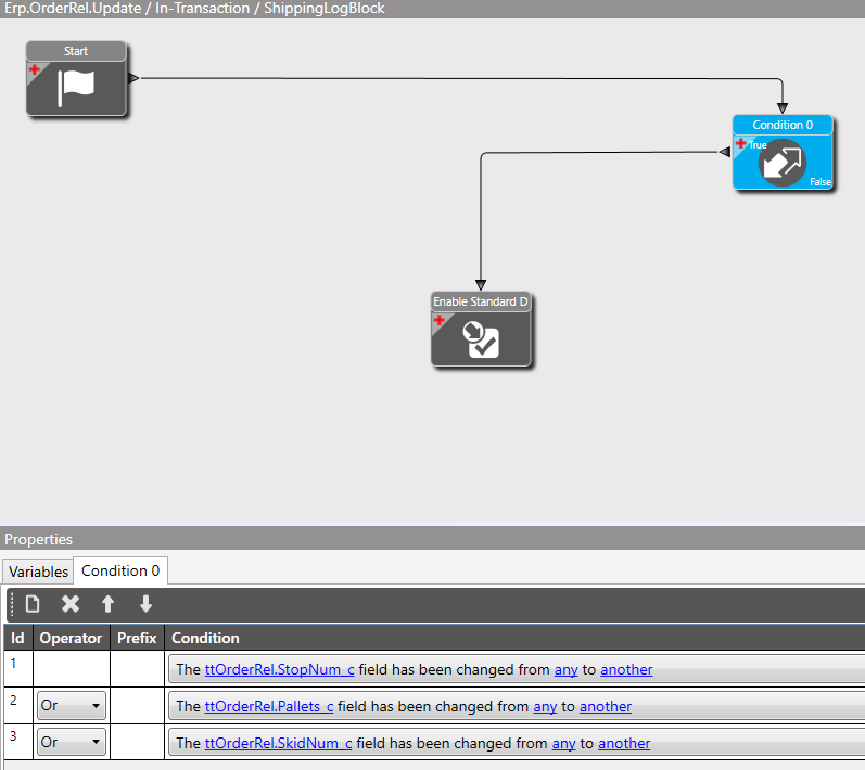

Data Directive on OrderRel,In-Trans:
Then in the below setup, I used the email to tell me if it was going through. Everything works until the Condition. Once I used the Condition 1 (highlighted), it no longer works. Also, I notice that it still writes to the Table even when I set it to terminate after the Trans to Standard.
Assuming the RV1 is what you used for GetByID there - there is no updated RV1 row after GetByID. Try using the ‘unchanged row’ instead of ‘updated row’.
My boss changed the field to everything on OrderHed, so this was easy to do in the BPM itself under the Pre-Processing. Works perfectly!
