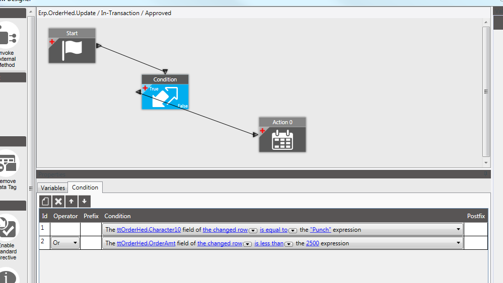

Would you mind posting a screenshot of your BPM workflow?

Just to be thorough, I’d do the following.
Does the order in question have “PUNCH” as OrderHed.Character10?
Have you verified the value of ttOrderHed.OrderAmt?
Given the “OR” logic, I’d definitely make sure that your incoming values are what you expect.

Have you tried changing the row from the “Changed Row” to the “Updated Row”?

When this happens to me I separate the conditions into their own. This ensures that I’m getting the correct trigger.
From what I see now its that if the order is “PUNCH” then check the box. If the order is less than 2500 check the box. If the order is both check the box.
I’m not sure if this is what your trying to accomplish. I would think it would be “PUNCH” AND less than 2500 check the box but it isn’t right now.
You may want to consider throwing some displays in the BPM. I’ve found that Epicor can be funny with all their different fields. For example, while working on directives on the some of the discount fields on the OrderDtl table,there were “DocDispDiscount” and “DocDiscount” and “DispDiscount” and “Discount” - basically what seemed to be a dozen different fields. I’ve found that the BPM’s were touchy as to which ones I modified, and the one I modified in the directive was different that what I did in the UI code.
So perhaps that’s doing something like that here. Throw some displays in there to display the value of OrderAmt. My guess is that when the directive is firing, it’s zero at that time - and it’s getting updated somewhere else. Then, look at the DocOrderAmt field.
