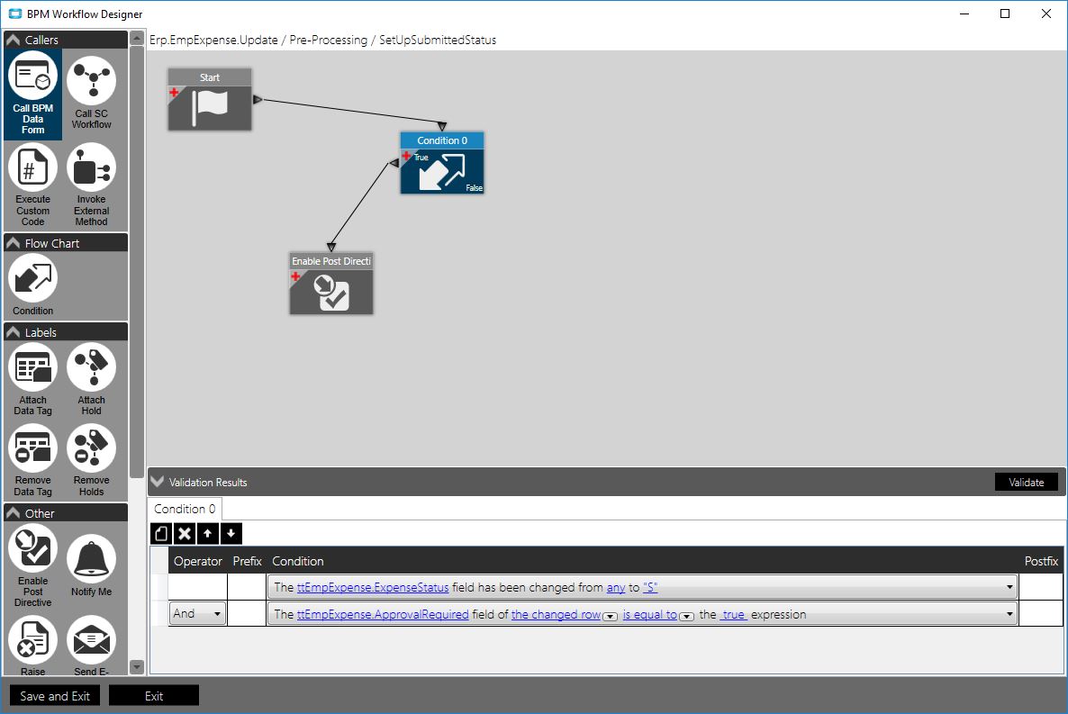

For employee expenses I have made a pre-processing directive on the conditions that an employee expense status has been changed from any to ‘S’ and Approval Required is true.

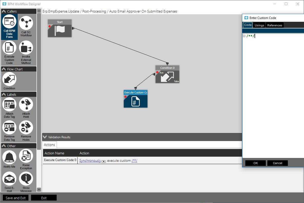

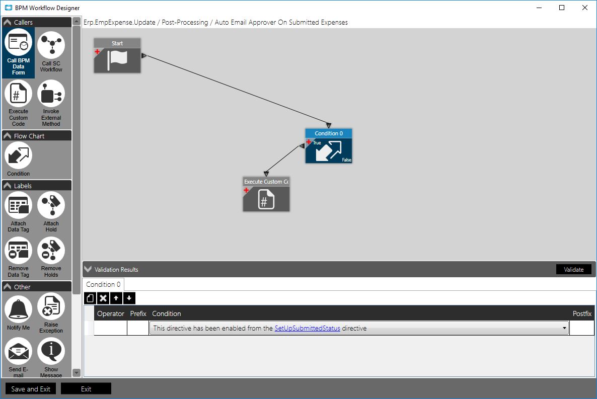

Then I’ve set up a post-processing directive enabled by the pre-processing directive, but don’t know what code to enter.
Any helps or pointing me in the right direction would be great!
