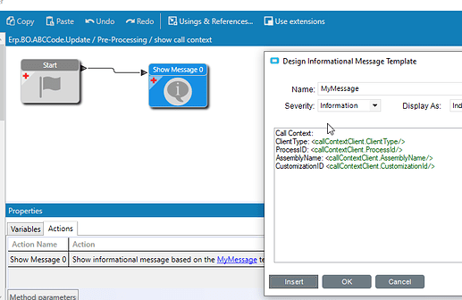

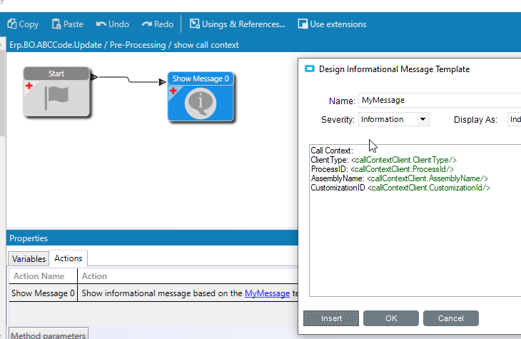

  1. start by making a very simple BPM against the business object you are going to run. In my case, i was making the BPM on ABCCode.Update in the PRE processing method.
  2. I created a Message Display box, and displayed all the context fields I was interested in possibly looking at.

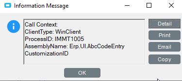

  3. I enabled the BPM, and then went to ABC Code Entry and modified the record. When I saved it, the following popped up:

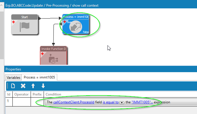

  4. NOW, i can go back to the BPM, remove the display, and add a simple condition to the BPM that checks for the condition I want. In this case, I want to only run this if the ProcessID is IMMT1005… but I could check for only running my BPM if i am in a certain customization, or on a certain client type:
