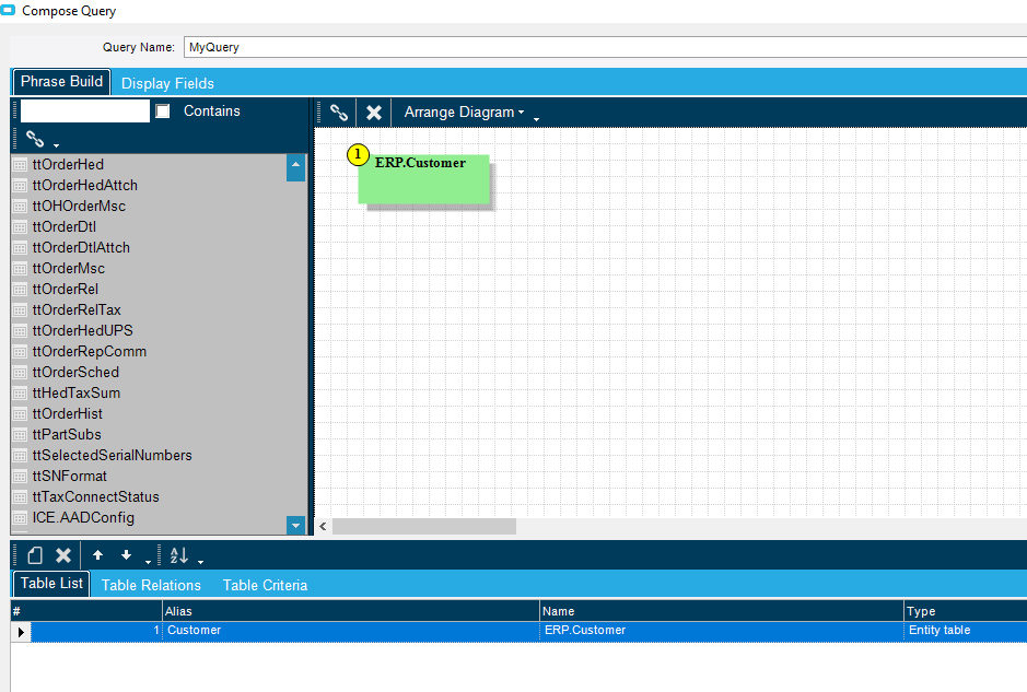

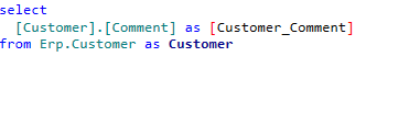

Its a very simple query I am using to get the customer comments from customer table.
If that is really your query, that will not work, as you do not have a join to the current ttOrderhed table in your query. Or if you do not want to use the ttOrderhed table for your join, then you would at least need a WHERE clause against the CustNum argument. Can you post an image of your Query table design?
The ChangeCustomer should have a variable you are using to filter the Customer table so you get the single customer’s comment. If the variable does not exist, join to your ttOrderHed table and include the company and custnum in your join.
Sure Rick
I do not know how to design
This is returning EVERY customer. Likely the first one in the list has an empty comment.
You MUST filter the query for the customer you need.

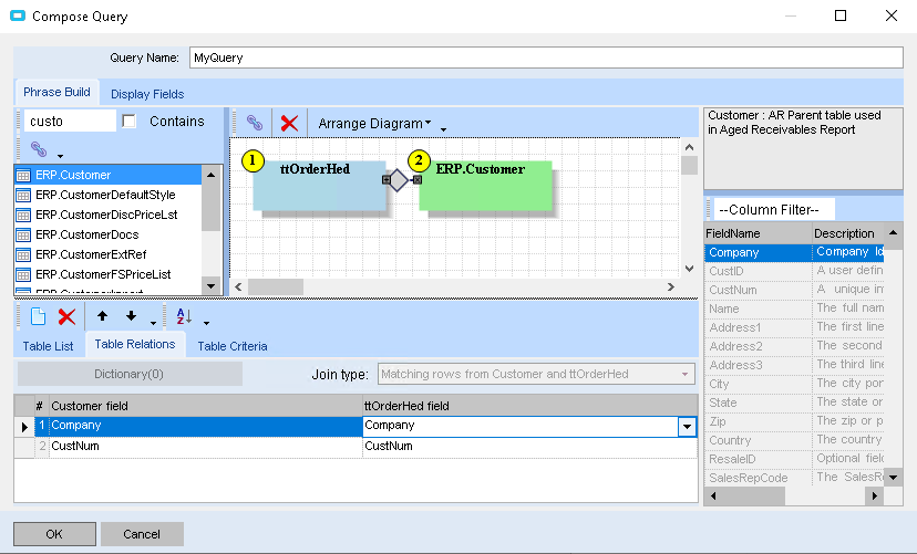

For the Update Table By Query widget to work you need to have fields that define the relationship between your query results and the ttOrderhed (temporary table) so it knows what to update.
One way to do this would be to add the ‘ttOrderhed’ table to your query and define the relationship between the two tables as:
ttOrderHed.Company = Customer.Company
AND ttOrderhed.CustNum = Customer.CustNum
Now add those two fields to your results under ‘Display’ and also add the OrderHed.OrderNum
Now in your Update by query widget you should see that a relationship is automatically made.
If not, you can define it.

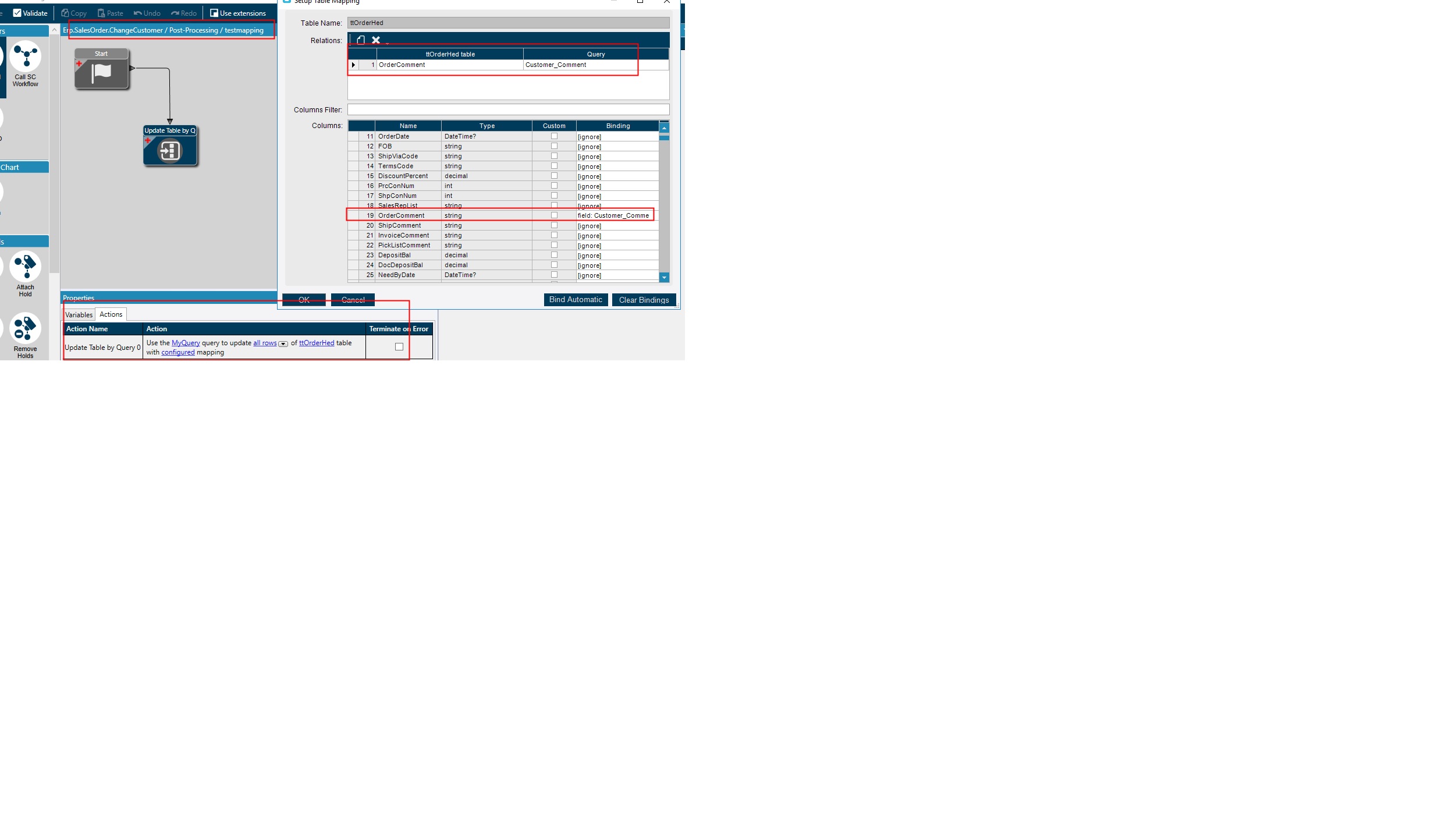

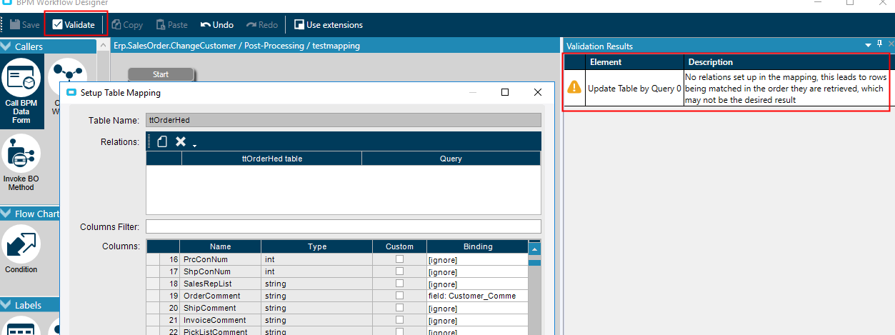

Thank you so much for helping me Jason. I followed the same steps as the screenshot attached. But when I click validation its giving the results as attached below
This can be ignored.

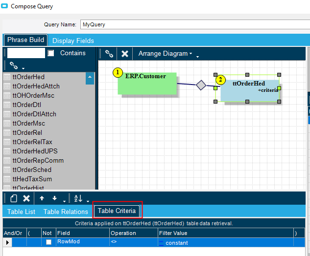

Sorry for the late reply I was asking about this Table Criteria
The BPM will sometimes have two rows in the dataset. One is the old row, and one is the new or updated row. The system uses these two rows to compare what changed. The old row doesn’t have a row mod, so that filter is simply removing that row.
