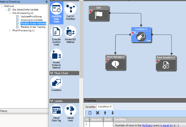

On our Sales Entry screen we have an additional UD field called “Related Order” so we can reference child orders to a parent order. We are currently working on a simple BPM to make sure the “Related Order” entered is an existing order in the table.

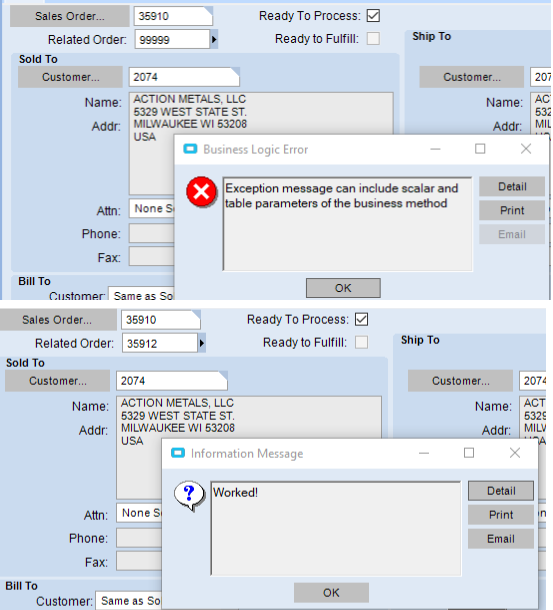

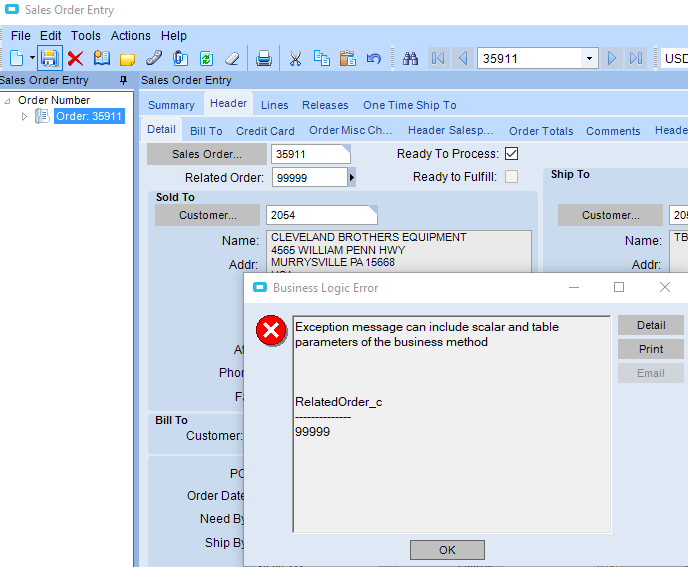

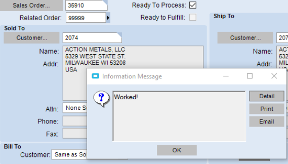

When testing the BPM, it works as expected and I am getting an error when saving with a Related Order that doesn’t exist(99999). But right after I save a Related Order with a correct Sales Order, I can change the Related Order to any nonexistent order number and the BPM won’t raise an exception. I actually get my Message saying it worked, meaning it is passing by my condition?

I used the tracer and it is using the “MasterUpdate” method. I tried using this Pre-Processing BPM on both the “MasterUpdate” and “Update” method and I am getting the same results. I am new to Epicor and creating BPMs so I apologize if I get confused by any suggestions or questions asked.

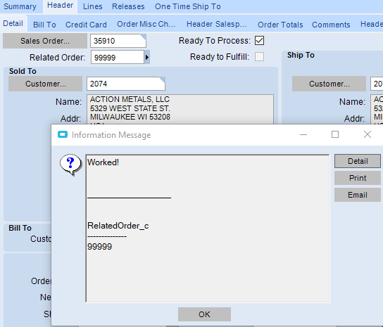

On your query, are you getting more than one row? Sometimes the TT table has 2 rows. The changed and unchanged one.
To find out, do a message box and add a field query, or row query (right click in the message) and see what rows are being returned. If you have 2 rows, your condition is going to fail. Or if the unchanged row has what you are changing from, you’ll get one. You probably need to add a filter to the ttTable for only rows with a rowmod. (A, or U).
@Banderson looks like it is returning one row, the changed row!
changed
Where would I add the filter you mentioned? Within my query or a different part of the BPM?
Actually, when I am able to get the error to pop up for the first save, I still see the changed row here. So I am not sure why it is being accepted after the first save.
I just added a filter to the Query to set rowmod to “U”. Now the BPM is working as expected!
However, I am still pretty confused as to how the solution happened.
the problem as previously stated is that there are TWO rows returned when you modify something vs only ONE row when it is being added. You only want the row with RowMod <> “” (the A or U valued row).

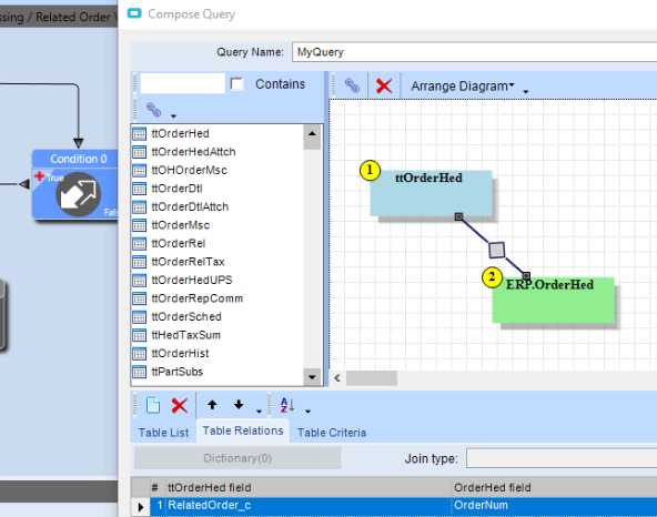

there is another problem with your BPM. You did a query that links the TT row with a real database row, and that can be bad and very inefficient (taking lots of time). It would be better to:
  1. create a variable for Order Number
  2. Populate the Order number from the TT row with a setter widget
  3. THEN in your condition, instead of connecting the tt row to the Order Header row, you simply filter the order header row by the order number. This will return the value much faster.
