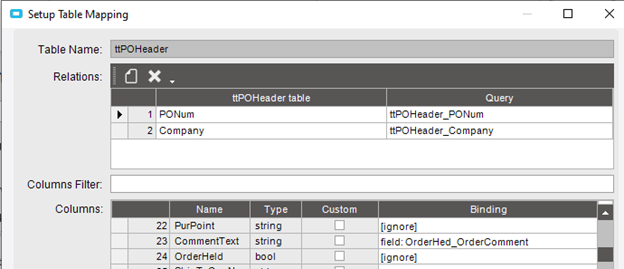

The mapping says to match the query results on PONum and Company and then to bind the POHeader.CommentText to OrderHead_OrderComment from the query:
When I make a change to the PO, Message 0 (positive) is displayed, but the PO Comments are not updated. I have verified that there are comments in the SO header.

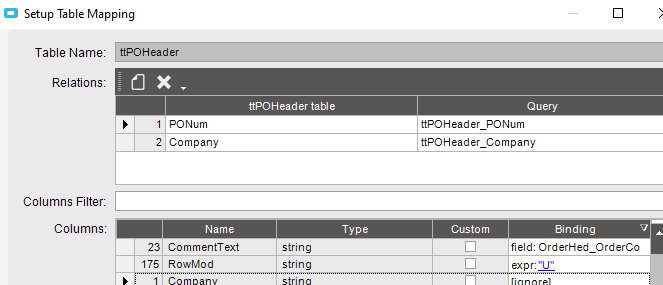

If this is what I was supposed to do, it did not work:
Try changing the before condition from “for changed rows” to “all rows”
Already is…
Wasn’t in your original screenshot :man_shrugging:
Sorry, thought you meant the condition for selecting the records I really need a BPM for Dummies…
Still not working, even after change:
