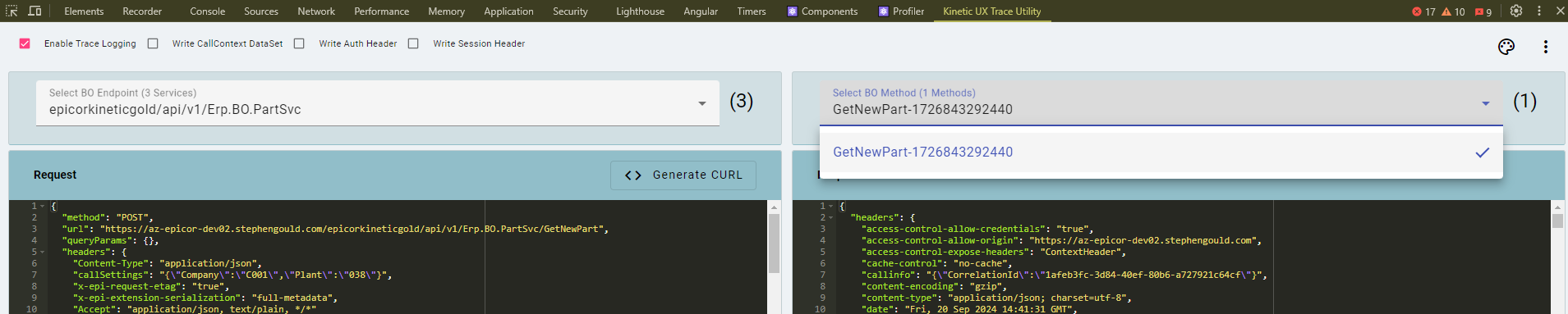

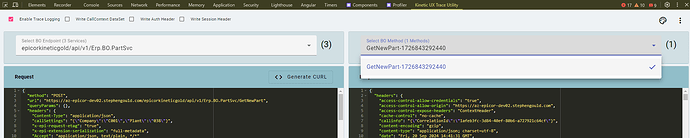

I think I need a little bit more context here because there’s no way your BPM should be interrupting an event that happens on the UX. What I have noticed is that in the web version Epicor has taken a lot of liberties with their BOs and gone as far as creating brand new methods for a lot of business objects.
Have you run a trace (Front end) in the Kinetic UX for adding a part and did you make sure that Epicor Isn’t Invoking a different BO? Or is your BPM On GetNew doing something to the UX I don’t see how that would happen maybe via BPM Data Form?
A quick trace show they are just calling GetNewPart :thinking:
Hold on, I’ll recreate it.

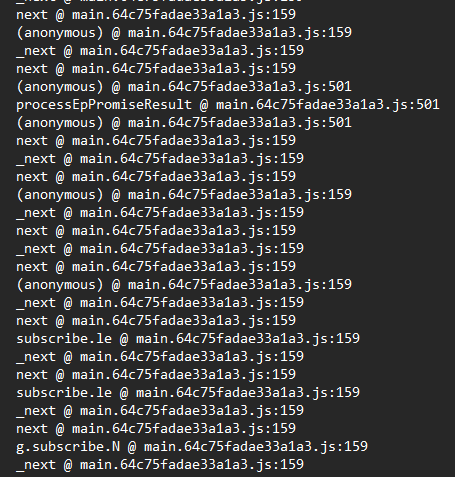

Does anyone know if there is a way to export the Console without all of the extra gibberish that comes along with a copy and paste?

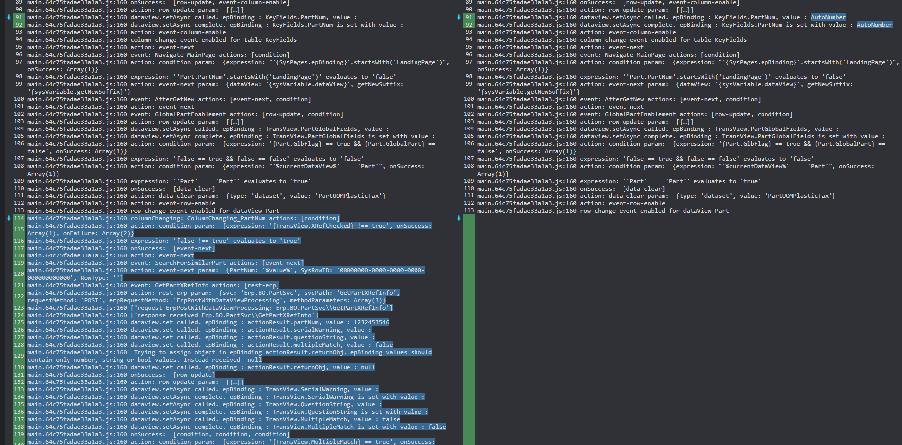

Yeah, that’s what I did, but it comes along with 100s of lines of gibberish like what was in my screenshot. It’s just a pain to then go through and delete it all.
Here is a screenshot of the console for Base screen and Base screen with BPM. BPM is on the right.
This is what I think is happening.
When you call GetNewPart, it returns an empty data set to the browser. When that data set is loaded, they disable events.

Here is the same section from the BPM one.

Then, when the user enters a part number and tabs off, the ColumnChanging_PartNum fires. In my screenshot above, that is where the two versions start to not equal. There are multiple events that fire after ColumnChanging_PartNum that do not fire with the BPM version. Below is all of the lines that did not happen with the BPM.

Since the events are disabled when the data set is loaded, it does not know that the part number changed. Then all of the subsequent events that are trigger IN THE BROWSER do not trigger.
It is the ChangePartNum rest call that is not firing. If you look at the Payload and Response for it, there is no IUM in the Payload but there is an IUM in the Response.
Since the ColumnChanging_PartNum is not firing, the rest-erp event below does not happen and the default UOMs do not get applied.
main.64c75fadae33a1a3.js:160 event: ChangePartNum actions: [rest-erp]
main.64c75fadae33a1a3.js:160 action: rest-erp param:  {svc: 'Erp.BO.PartSvc', svcPath: 'ChangePartNum', requestMethod: 'POST', erpRequestMethod: 'ErpPostWithDataViewProcessing', methodParameters: Array(1), …}
Is the Change PartNum event not happening because you doing it in the BPM?
Yes. I am setting the PartNum in a Post Processing BPM on GetNewPart.
