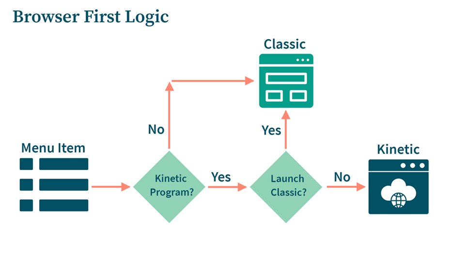

I just spoke with EpicCare yesterday and they mentioned that if a page doesn’t have a Kinetic version, it will open in the classic screen. It only does that if you have the Kinetic Edge Agent installed. I just tried opening Directive Export and it prompted me to install Edge Agent, which I have never had to use. Let me know if that clarifies anything for you.
Yes, I have the Edge Agent installed, and that makes sense. The browser isn’t supposed to be running external programs locally (think of the security risk), so it’s the Edge Agent doing the heavy lifting.
This is new since a few versions ago when I’d just get an error message saying, “Not Available in the Browser” or some such.
@Ernie here’s a rabbit hole around that topic for you, lol.
New “feature” in 2023.2 - Kinetic 202X - Epicor User Help Forum (epiusers.help)

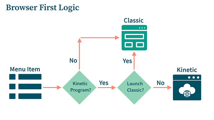

That is the same exact flow chart they gave me yesterday.
Here’s the updated one:
