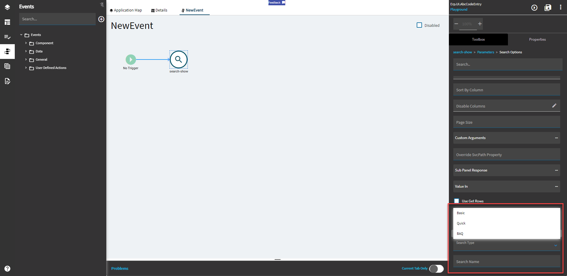

What version of the UX is this? Also Either Way Quick Search is what you want here.
A lot of information on how to use Quick Search built in to the help

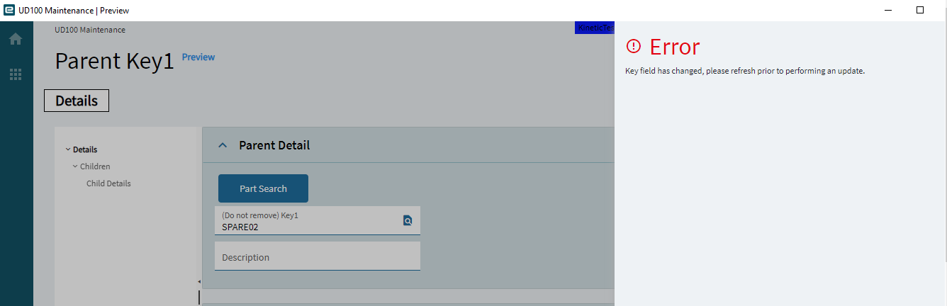

Epicor Version-2022.2.10 ,I am looking for Button Click event some how i figure out half part ,now when button click base part search open, but i don’t know how to set the partNum Vaule to Ud100.key1.

Use a quick search information available on the epicor help

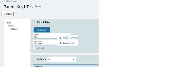

Quick Search not working on UD100 Table, its working on Part Master Screen.I checked
Jose is correct, you need to wire up a Quick Search.
Plenty of info here: Epicor Application Studio: SEARCH - Kinetic 202X - Epicor User Help Forum (epiusers.help)
Even more if you search the forums; the info is out there.
For UD Tables Quick Search needs to return SysRowID,
1.Not working after return the sysRowID,

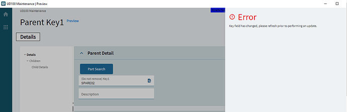

2.Set the value key1 but when saving error throws ,any one know how to solve .
After you set the field, use an event-next widget to call KeyField_Changed.
