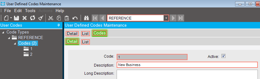

Being fairly new to Epicor customization, I want to add a button called “Reference” that will search the “UDCodes” for CodeTypeID “REFERENCE” and then display the CodeID and Description in search window (see screenshot). When one of the row is selected, it would put the description in the “Reference” textbox in Opportunity/Quote. I went to customization wizard and add a simple search adapter for “User Codes”. However, I can’t get it down to the correct CodeID in the search window. It is only searching the CodeTypeID and not the CodeID. Any ideas?
