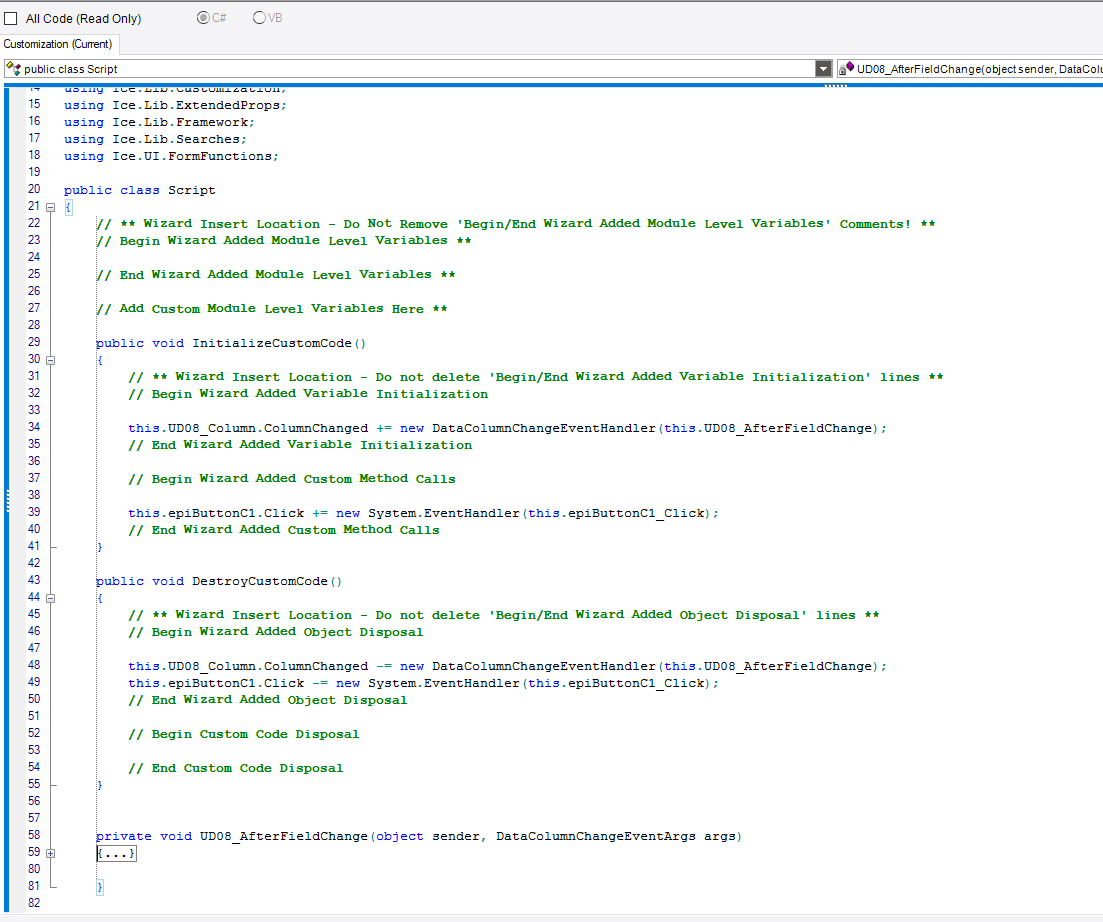

I am trying to add a search button to my UD08 entry screen. I have added the button and used the Simple Search Wizard to call the Part Search and set it to Key2 in my UD table. When I look at the code to add the call to the search adapter to my button event there is no code for the search adapter. I’m not sure what the issue is. Am I missing a step? Am I looking in the wrong place?
If you removed some of the Epicor native comments in the customization the wizard will have a hard time finding where to insert its code.
Open a brand new customization click over to the code tab and make sure all the comments that Epicor puts there are there in the right place. If not replace them / put them back and try again
