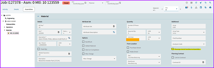

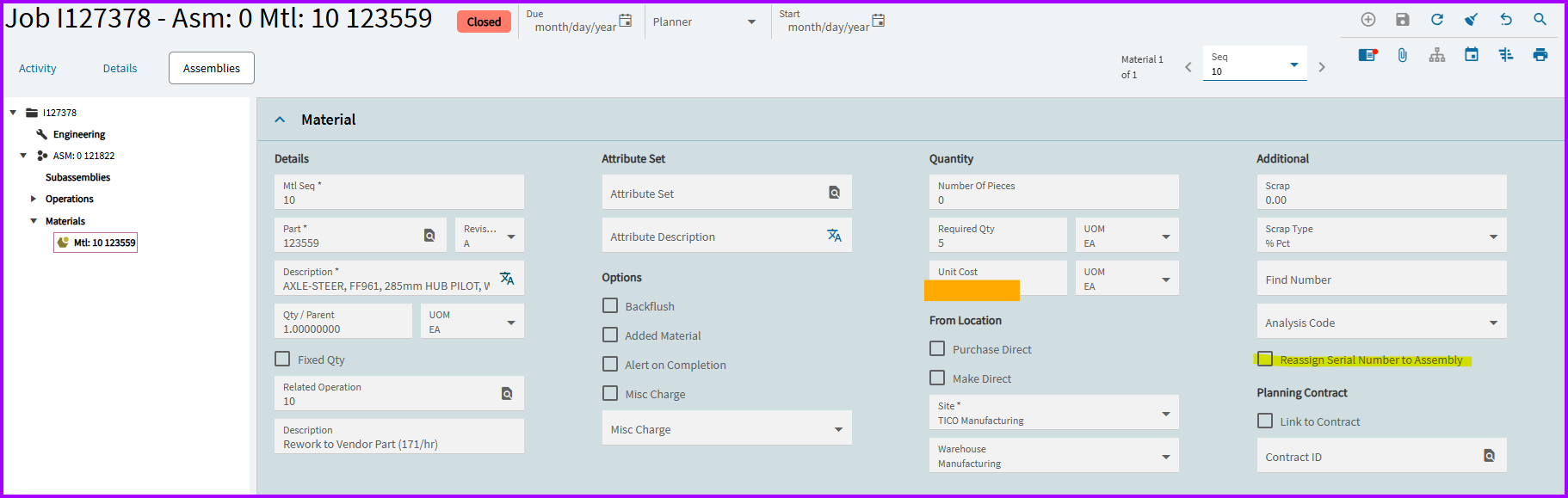

Third assumption
Job format is generally the same for all rework jobs.
Like this:
- The part that job is for (
JobHead.PartNum) is the same part as the part on the DMR - The material on the job is (to start with) only one item and is ALSO the part number from the DMR.
a. Qty/parent is 1 EA
b. Of course you may need to add more components, but that will forever vary. The point here is for a universal template. - At least one operation
a. I’ll make this an input, but intent would be a specific rework operation that has a special (exorbitant) burden rate - Product group - also an input, also should be rework-specific
- Demand link
a. Depends on source - see “Second assumption” above.
b. Qty is DMR quantity… or probably the remaining qty (not yet dispositioned). Again, it’d be an input regardless.

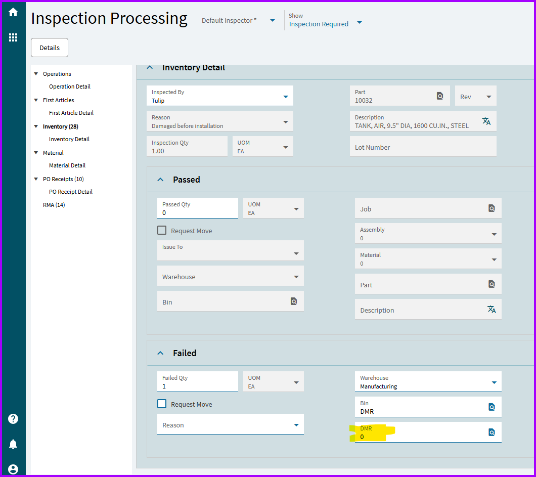

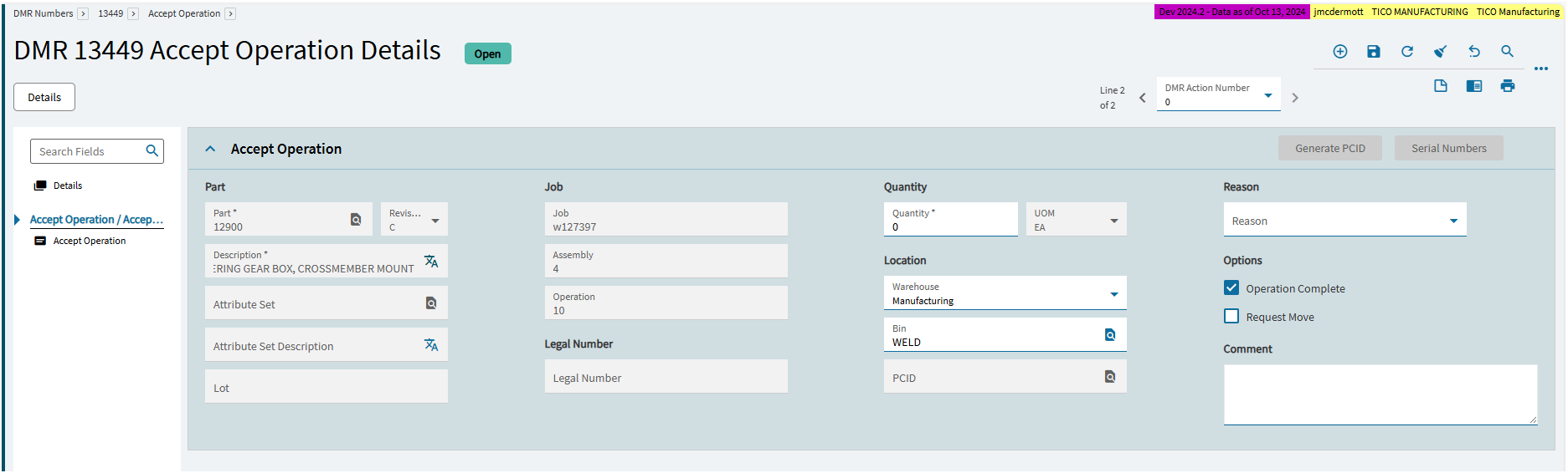

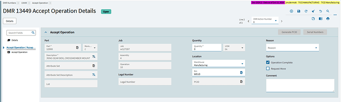

After job is created, just go ahead and issue the material from the DMR to the rework job.
Which is to say that you’d create a DMR action for Accept Material.
- Needs a reason code
- For me, the location pre-populated after I entered the Mtl Seq.
