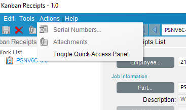

I’m doing some small streamlining of the Kanban Receipt. Our users enter in a new lot number in the lot field and the Are you sure you wish to create a new Lot? prompt shows, I’ve taken a look at the trace, in Kanban Receipts.ChangeLotNum thinking that there would be a field like you can set to bypass the prompt similar to the situation after print a packing slip in Customer shipment entry, when you close the print dialog it Epicor asks if the Packing Slip is ready to ship.
There is a parameter. IValidLot in the Method, I was hoping that was the trigger, but sadly it doesn’t suppress the message.
Is it possible to disable this message without having to create the lots first?

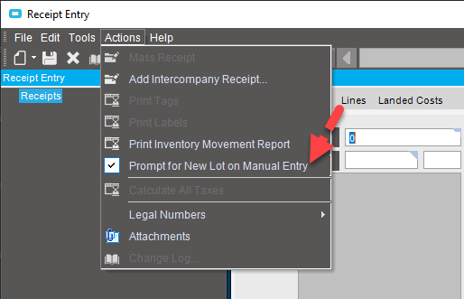

I don’t use Kanban Receipt but on other receipt entry screens, there is an option in the Actions menu for “Prompt for New Lot on manual entry”
I think that’s how to control the prompt
Thanks @Aaron_Moreng I was readying my FacePalm meme…Alas no cigar. :frowning:
I’m interested though I’ll go and take a look at the receipt form. For now, I think that they users are snookered and they will have to put in the lot numbers in advance.
