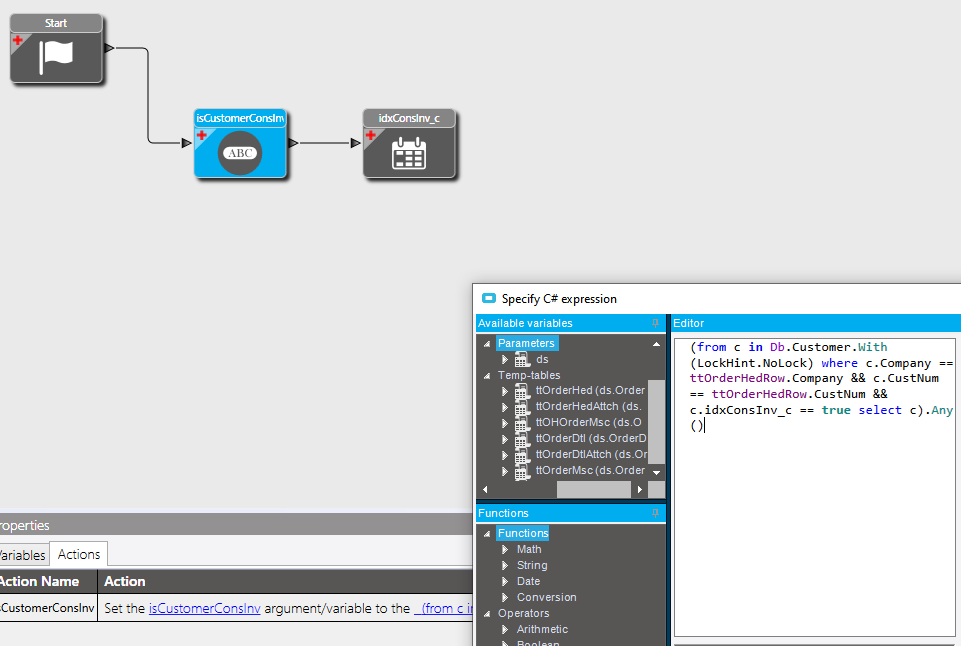

Example of an Expression returning t/f because of Any() from OrderHed.

This is a great help for me to see an example. Now if I just had an example that returned a value instead of True/False.
(from oh in Db.OrderHed.With(LockHint.NoLock) where oh.Company == ttInvcHeadRow.Company && oh.OrderNum == ttInvcHeadRow.OrderNum && oh.idxConsInv_c == true select oh.OrderNum).DefaultIfEmpty("").First()
