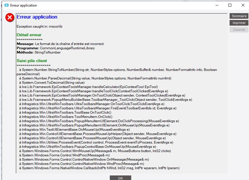

Issue one: Selecting the calculator was giving a stringtonumber conversion error:
I noticed that the user Windows decimal separator value was set to comma. I changed it to a period, and it resolved the error. (showing that the conversion is not taking into account this setting)

Moreover, even if the user is correctly setup with a period as the decimal separator, it shows a comma into the numeric field. I beleive it is causing the issue…
Question: Where is this changed in Epicor? My assumption would have been that it uses the Windows setting… but does not seem to…

I would assume it will be either the “user account” settings in Epicor under the Format Culture or windows lanuage and region settings.
Thanks DAN that was it…the format culture.
we use French language, but to have the period, we need to use English format culture.
Change it and all worked as expected…
