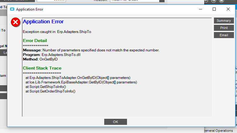

The Company, ShipToNum, and CustNum is correct so I’m sure my issue is the code syntax. I’ll see if I can figure out GetByID call to ShipTo

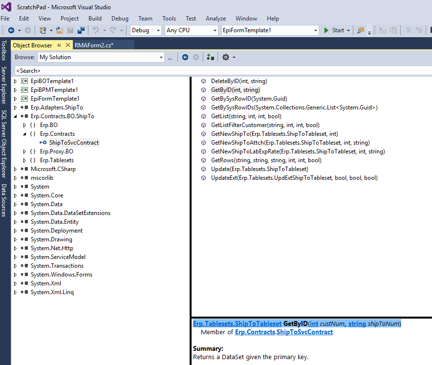

Still something with the syntax it seems. This brings me to a question: Where can I find information on the methods, ie: GetByID, and Adapters?

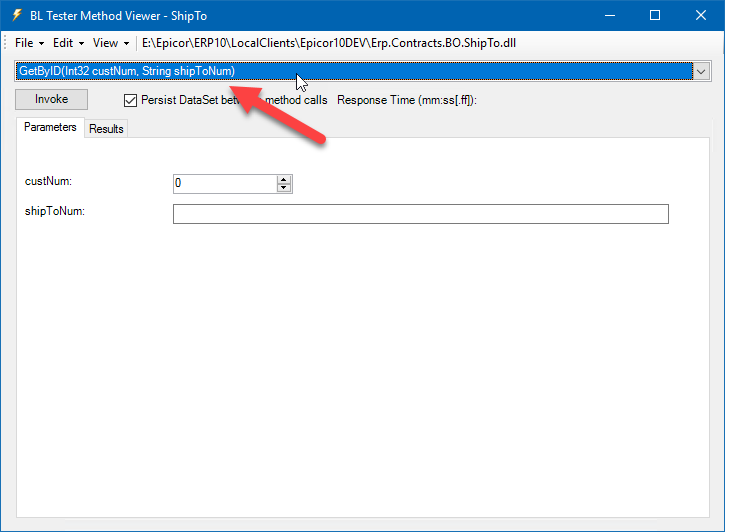

Object Explorer will show you all the methods and properties of an adapter, although sometimes using the Business Logic Testers is a little easier to visualize.
So it looks like we don’t need to pass company, just custNum and shipToNum
Awesome, lucky we don’t have multiple companies anyway. :smiley: I found it pretty easy in the Object Browser in VS, once I added in the ShipTo DLLs

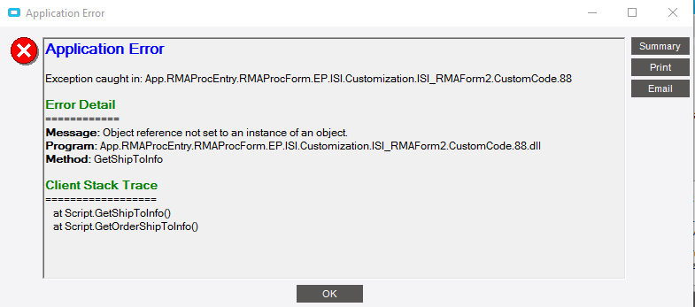

So close! It’s got to be with the EpidataView declaration. It passes the F5 code test but I get an error when I run the form.

To here everything is golden, then I tried to pull data from ShipTo. For example when I tried, string STName = row[“Name”].ToString(); a test compile gives the error: “Cannot apply indexing with [] to an expression of type ‘object’” I’ve seen this before and had to make a EpiDataView. Which is the code giving you hives. :wink:
I’ll keep working on it.
Randy,
Use the debug option in VS in your customization and step though. I’m sure that will help pickup your null reference issue.
