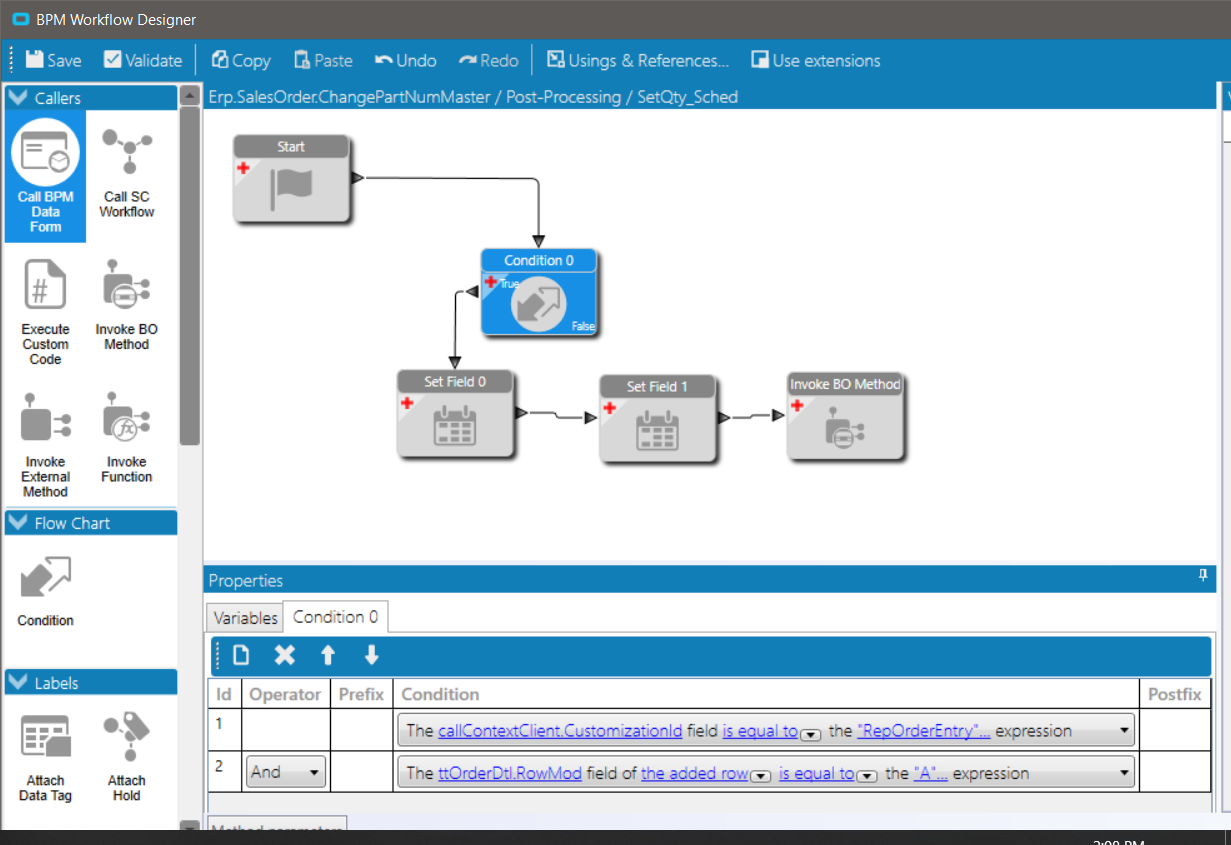

One is a Post-Processing directive on SalesOrder.ChangePartNumMaster that sets a UD field to a value, a UD Checkbox to True, and Invokes the SalesOrder.ChangeSellingQtyMaster Method when the following conditions are met.
  • callContextClient.Customizationid = “RepOrderEntry” AND ttOrderDtl.RowMod = “A”

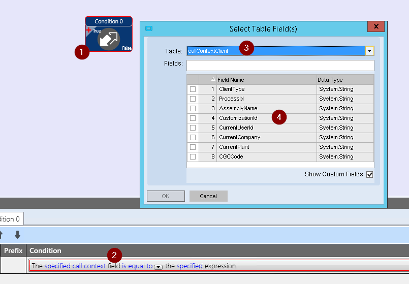

I’ve put in a screen shot of one of my conditions.

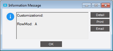

Use a Information Message to display the text you are comparing. This will show you if the CustomizationID is blank or not.

Using Jason’s suggestion, I found that the Customizationid isn’t being picked up by the BPM.
After the user logged out and back in, it suddenly has the Customizationid.
