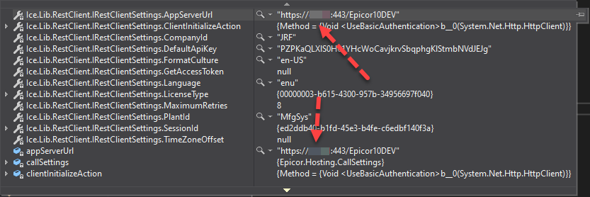

So I’m running in this issue as well. I did change my sysconfig to be the FQDN, but that isn’t what the RestClient is reading from. In fact I do not know what the RestClient is reading from because it seems to be unrelated to the Host Name in IIS bound to 443.
We have a wildcard CA cert applied to this port, so I would assume that it would accept the value but I have not a clue where the RestClient is reading the value from.
In debugging I can see it’s getting this from somewhere, but it’s not clear where from:
Did you ever figure out where that value is from?
@Aaron_Moreng it builds it from the AppServer URL and the HomePageURL (both of these are in your SysConfig)

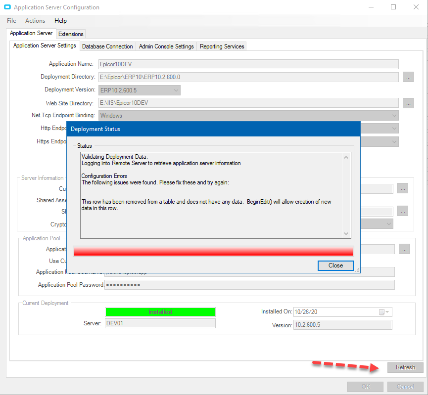

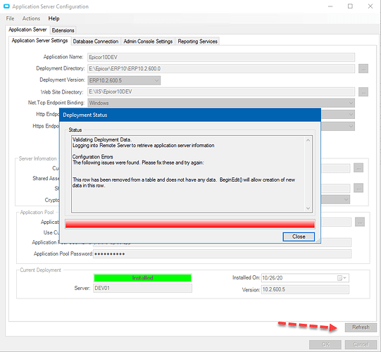

When I renamed the server on there to the FQDN, it “works” but it does not change the deployment server name. Furthermore, it does not allow the existing deployment to be altered, as the server name in the deployment now does not match the server name in EAC. The option instead of “Deploy” is now “Refresh” and throws an error when clicked.

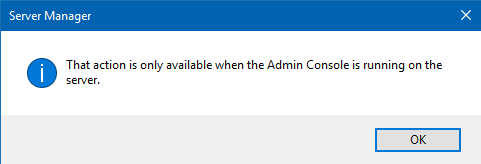

I thought then I could just create a new deployment under the server with the FQDN name, but it shows a message that “That action is only available when the Admin Console is running on the server”, which is clearly is since I’m on that server
