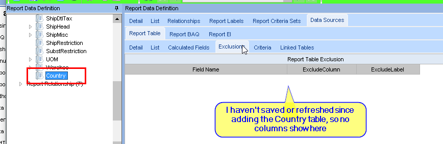

One thing I’ve found when using the RDD form, I often have to refresh the form after making a change, so that the change shows up elsewhere. Like if I add a table, the grid on the Exclude tab is unpopulated. So I can’t un-exclude the columns I need for that table’s relationships
Hitting the Refresh button (without ever having done a “Save” since duplicating the original), and the grid now shows.

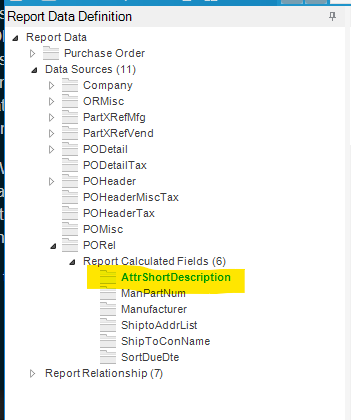

Here is where the AttrShortDescription is referenced in the standard RDD:
Do you have a custom RDD for your PO Form?
If so, do you see this in the RDD?

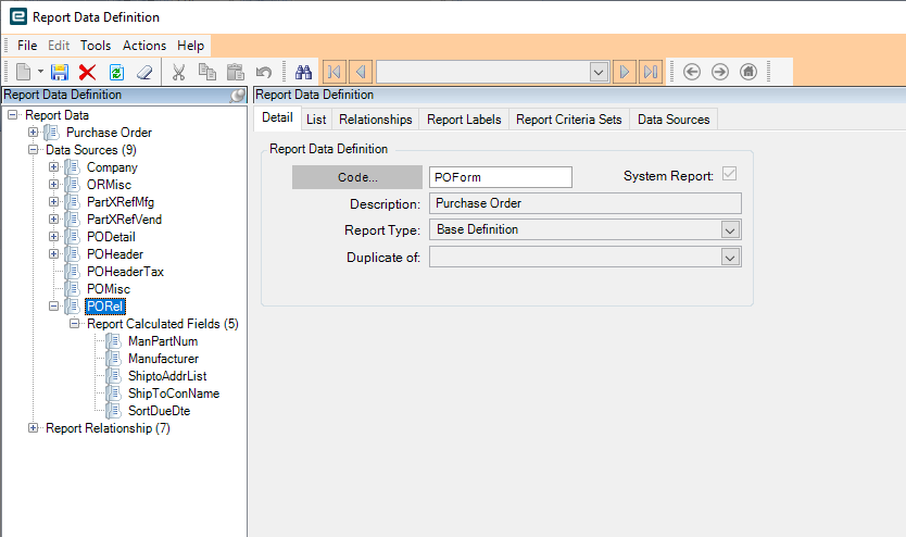

This is happening with the standard report, so no custom RDD. In the system RDD, that column does not show up:

Hmmm looking at 2021 and 2022 versions ‘Calc_AttrShortDescription’ should be on the PORel table as a calculated field… not sure why it’s missing from yours, but that is probably the problem.
If you check your Test & Pilot environments, are they the same version and do they have this field included under PORel?
Yes, we migrated from 10.2.400 to 2021.2.17 over the weekend.
In our test environment, the Calc_AttrShortDescription field is in the RDD! So interesting… thank you for pointing that out! I was thinking maybe I could export that one and import it into our production environment, but the export button is greyed out :expressionless: seems to be the case for all system RDDs. Going to add this to my case open with Epicor…
