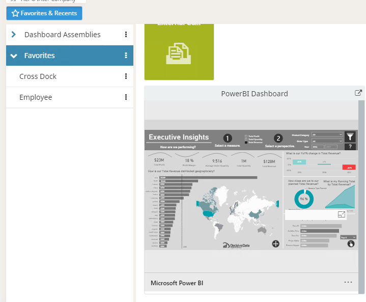

They have all of the charting and graphing as well. You can then display and interact with this in Active Homepage just like any other web dashboard by adding a link to the website.
Here is a PoweBI dashboard as an example.
Is that power BI professional I assume?
PowerBI Pro for the designers and the Gateway for Direct Access to the DB Power BI Gateway | Microsoft Power BI
Awesome, thanks
