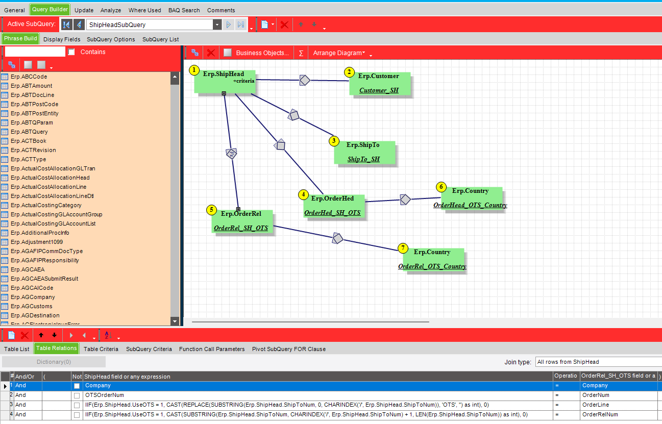

For OrderLine and OrderRelNum you use this formula.
For OrderHed you can use OTSOrderNum

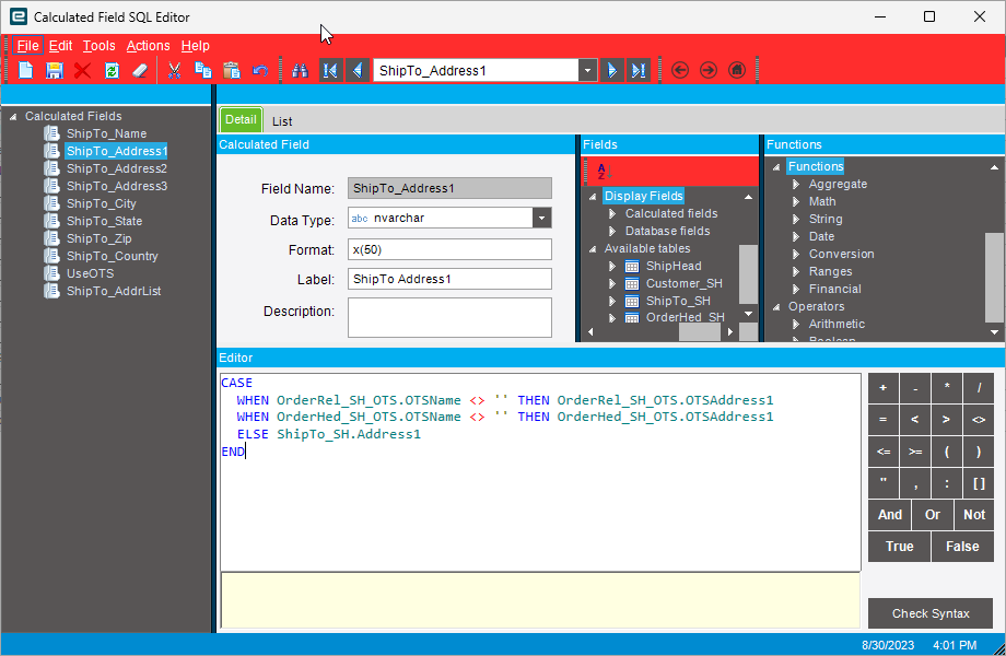

Then what I do is make a calculated field.
Awesome!! Thank you, great idea.
