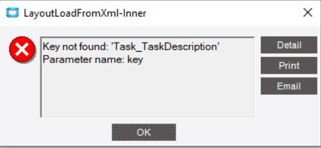

I am unable to open the dashboard with following error. Could anybody advise it? THX!
That doesn’t look like an error to me. Can you clarify?
sorry! Should be this
Looks like you removed a field from the BAQ that the dashboard requires.
only one person can not open this dashboard. Others are able to open it.
Have the user close Epicor and delete the C:\ProgramData\Epicor*-808 folder(s)
