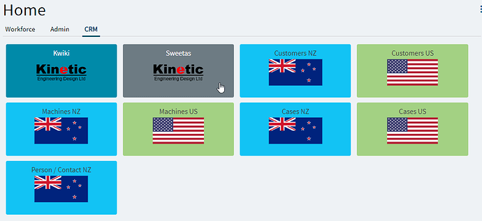

Thanks Mark,
This is my workaround for now… if I resize the window right I get nice USA and NZ columns :slight_smile:
