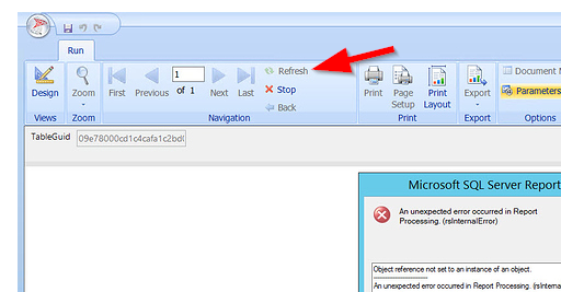

FWIW - When I preview in SSRS Builder, I get an error almost every time. I close out the error, then click the refresh icon (see below).
But to be fair, i’m not getting the error you see. Mine is more about the data not being found or current.

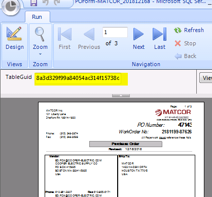

Here’s a preview made with a GUID that was not archived.
and here’s the Sys Mon the GUID was copied from:

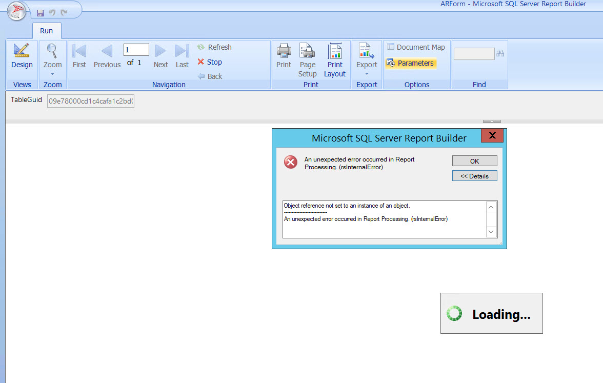

If I delete the report in Sys Mon, and then try to refresh in Report builder, I get:
Which is totally different than @tomdomurat is seeing.
It is NOT the GUID. I ran the report and made sure the Archive Period = Forever.
This issue is specific to the A/R Invoice as it uses some custom Epicor functions (that I believe are embedded in the CLSEpicor.dll).
The report renders for 1 second, then disappears and gives me the error message.
