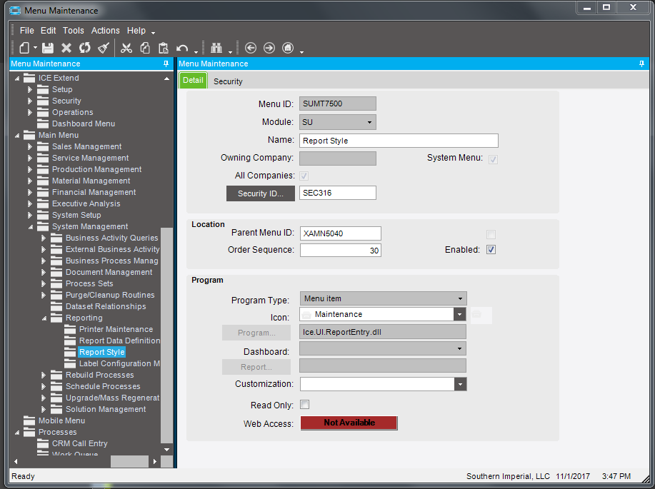

Mr. Don: Sounds like your menu item might be messed up - if you cannot even get to the report style form.
You might want to check your menu maintenance to make sure that menu item 1. exists, 2. has security that allows you access, 3 is pointing to the proper dll.

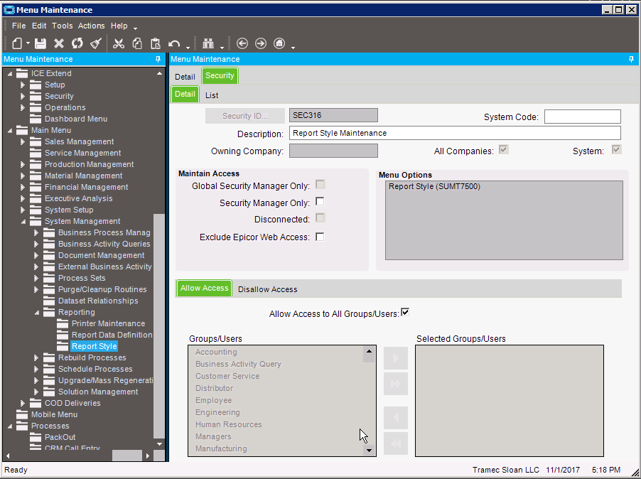

Here is the security screen just in case… The menu structure Reporting > Report Styles is open to everyone who has access to system management and I have access to that.

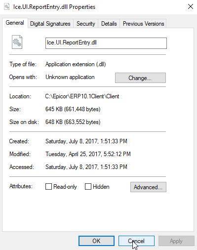

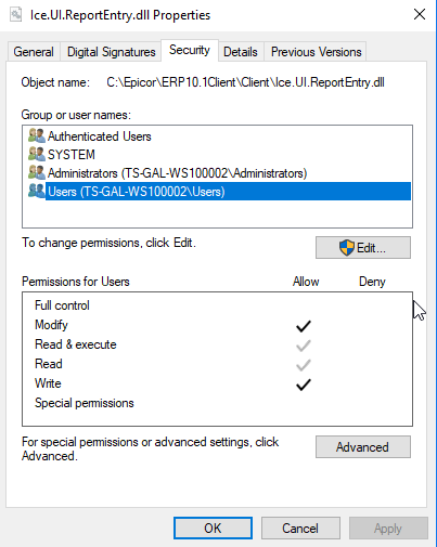

I tried manager, same error. I am able to create folders and files in the client folder where that dll resides. I gave myself full control to that specific file, still get the same error.

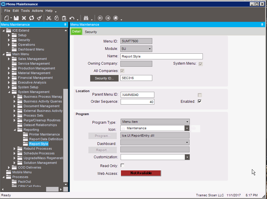

Just on a lark, try deleting the menu item (get copies of setting first!) and re-adding it to the menu. I have done that with Dashboards that have thrown the same error message.
We upgraded to 10.1 over the summer. I know it worked before then and I thought I’ve been in it seen the upgrade, but I’m not sure. A coworker can access it just fine. I duplicated his permissions as well and still get the error.
