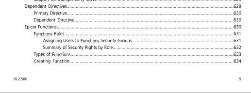

Is there documentation on functions in the ice tools tech ref guide?

You betcha. ICE Guide.
