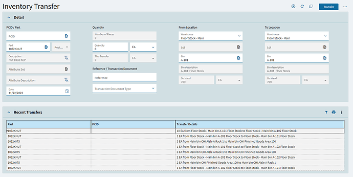

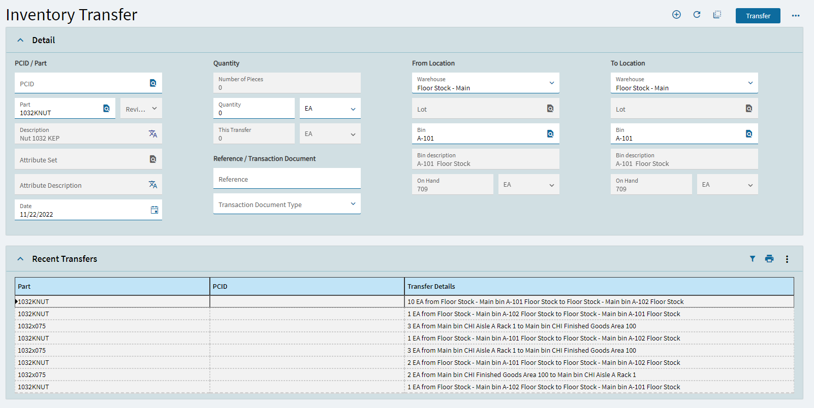

I know that this is an old issue, and it has seen recent comments… thought I would test and close it out. I just tested in the Kinetic Browser based UI, and it appears that this is no longer an issue. The system leaves the part number editable (as it should) and you can adjust things easily. I did multiple tests on various parts. As can be seen in the screenshot, i changed parts multiple times:
