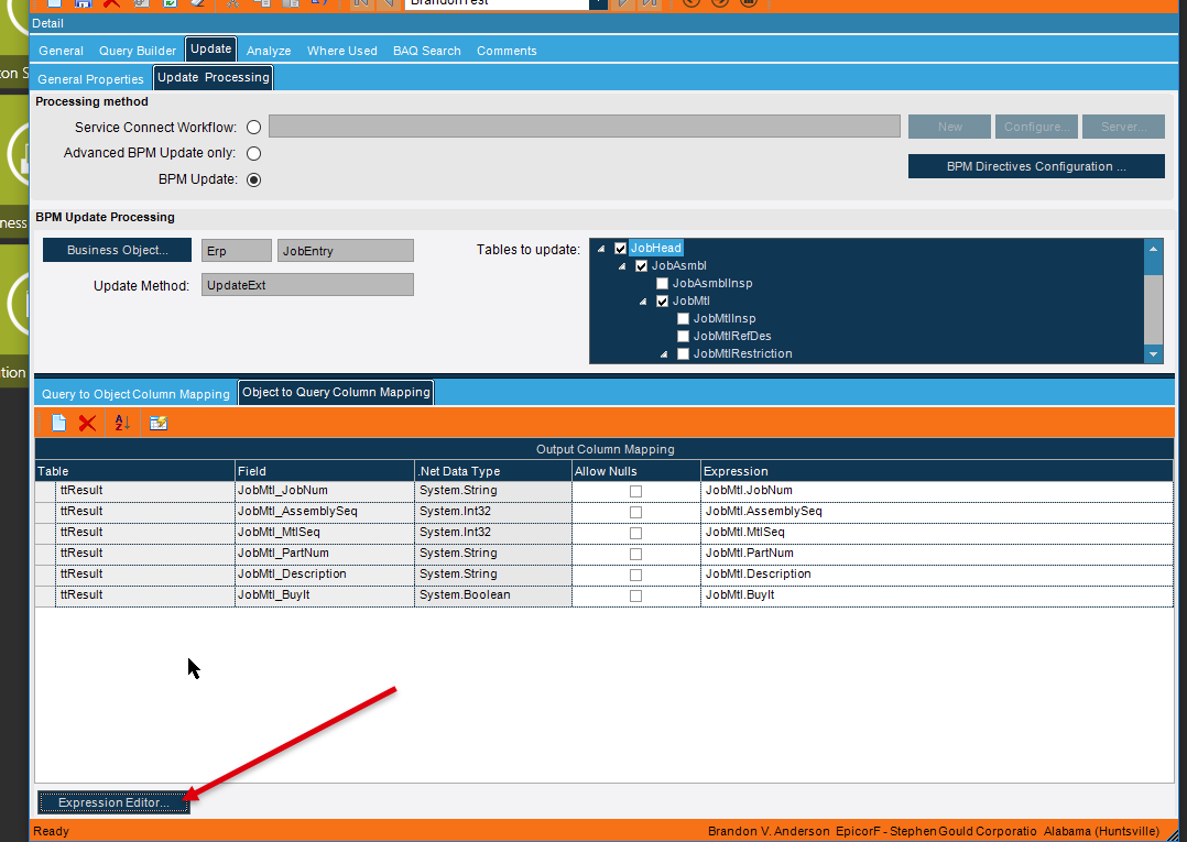

I don’t know what version you are on, but I’m 99% sure that those instructions should work fine. The piece you probably don’t understand is the this section of the updateable tab. You need to set this in step 8. This tells the Business object what the tableset field dspBuyit is supposed to be.
(note that this screen shot is just to show you were the button is, not how to set up your fields, so don’t use that as reference)
