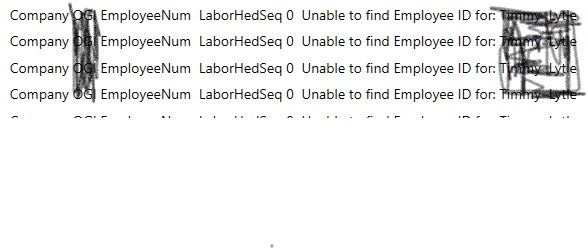

I am sorry I got incomplete information from the user. I am meeting with the user to get some facts straightened out. This may turn out that I was going in a rabbit hole. Once I get everything and all the facts established, I will reopen this if I need to. Thanks for all the help. As I have indicated before some of these things are new to me because I’m coming back to Epicor after a few years away. With the help of members here, I am recovering my knowledge of Epicor
I guess I was premature in stating that the problem was solved. It is now coming back with an error
Any ideas what it is I am doing wrong.
I do know for a fact that the EmployeeNum is there and I made sure format it as text in the .CSV file.
TE Labor Combined.csv (1.2 KB)
Attached is the file I am trying to load.
“EmployeeName” is not required in a TE Labor Combined DMT so I’d remove that column completely. As a general note, I’d only include the columns you really need to in a DMT.

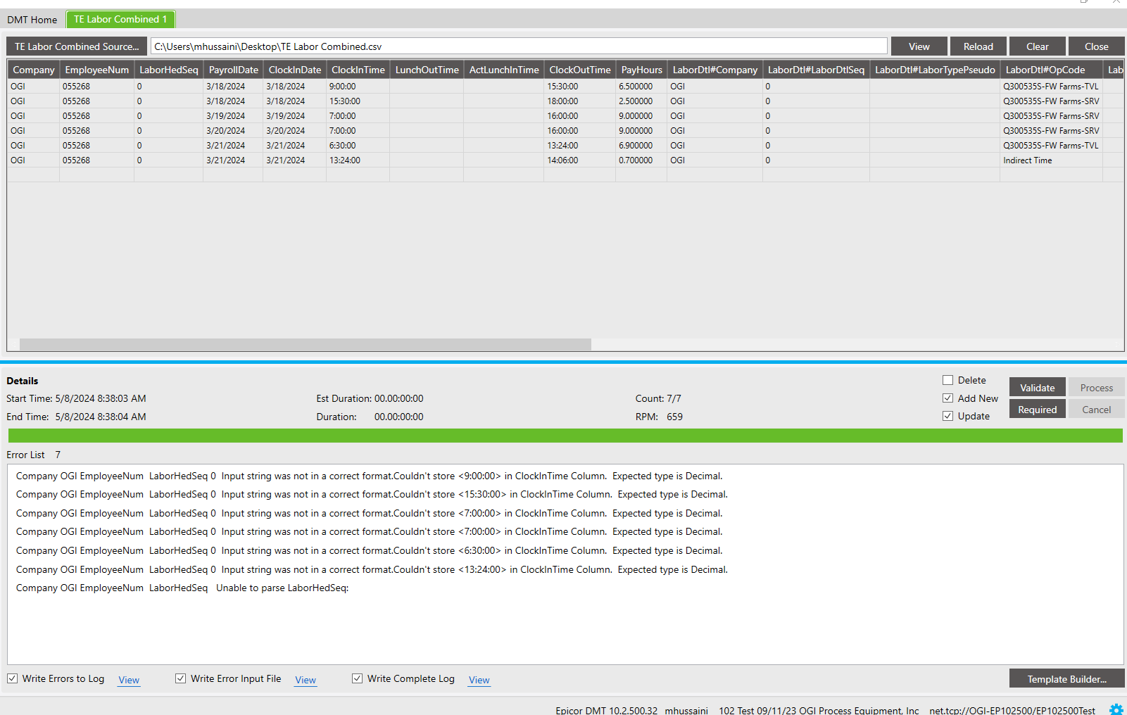

Here is the .csv file I am trying to load and a screenshot of the DMT and the error I am getting. I formatted the hours as instructed by Epicor.
I am very close, but I don’t know why it is rejecting the Time format.

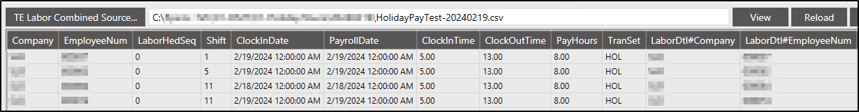

Try entering your time format like this
“5.00”,“13.00”
This is what DMT looks like when I upload a csv file to my system
Thanks, I just tried that. It looks like that works but I have another issue on Invalid Operation Code that I am going to try and see if I can resolve that.
Epicor is expecting those time columns in hours/hundredths not hours/minutes
Just looked at your import file again. The Operation Code field should contain the code(8 char max) for the operation, looks like you have the operation description in your upload.

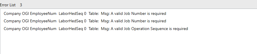

I think I am getting close, but I get
TE Labor Combined 2.csv.CompleteLog.txt (253 Bytes)
TE Labor Combined 2.csv.Errors.Reprocess.csv (503 Bytes)
TE Labor Combined 2.csv.Errors.txt (441 Bytes)
I am trying to find out where I need to go in the database to make sure that the Job Number does exist or not.
I did go into [Erp].[LaborDtl] to try and find the Job Number. The Job Number in question was not there. Does it have to be in this table if not, where would it be
One way to find where a field is in the database is to open the screen that you know it exists and then use Field Help. In classic, it’s under the Help menu. In Kinetic, it is enabled at the bottom of the Help icon.
Thanks, I was not very clear on my previous post. The post should have read where else apart from the Labor Detail table might the Job Number be store. I did look in the detail file and I couldn’t find it
