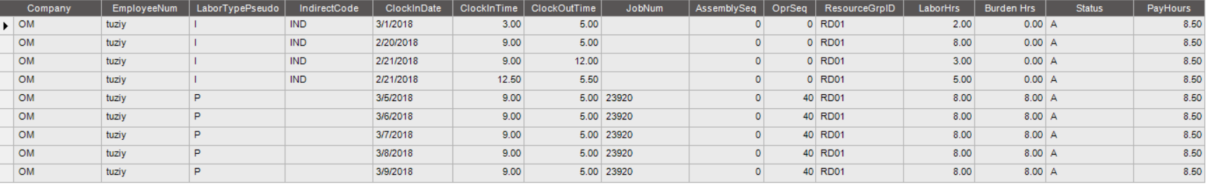

Now I am trying to figure out how to get the pay hours to be correct. It will not let me include payhours as a column in the upload. Below shows the BAQ results of the new records I created today.

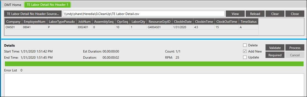

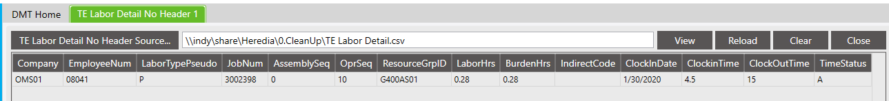

This is a sample row of what I got using TE Labor Detail No Header

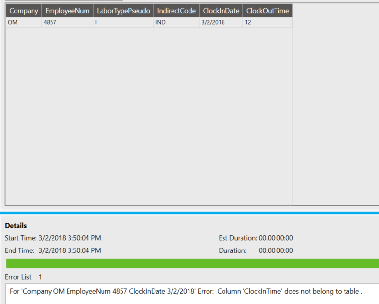

I’d love some help on this:

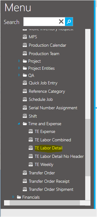

Which menu selection on the left in the list in DMT is this based on, please?
I am trying under Time and Expense Entry > TE Labor Detail

This is the DMT setup that helped me (TE Labor Detail No Header) :
