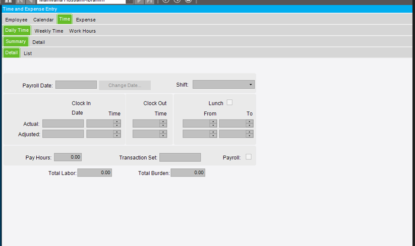

This is the screen for which I am trying to create the template
Sorry, sent the wrong screen. This is the one in addition to the Summary screen.
Are you trying to enter shop floor operators’ labor on jobs?
Which DMT program are you trying to use?
I am trying to create a template for Service hours from Field Service Staff.
