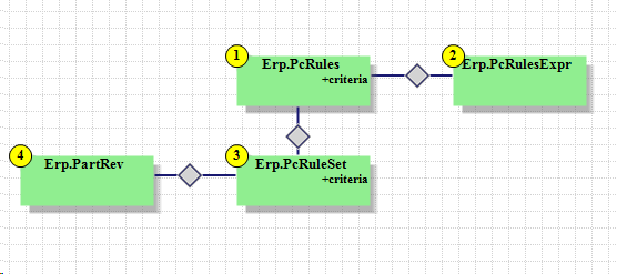

I created an Updatable dashboard to pull the configurator and BOM rules.
Exported the results to excel and made the code changes (replace JobAsmbl with JobMtl)
Paste updated into the Dashboard
