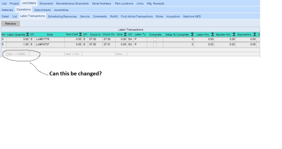

Is it possible to change the color or the background of grand summaries for Labor Transactions grid in Job Tracker?
I was able to only change the color for the header, but not the summaries.

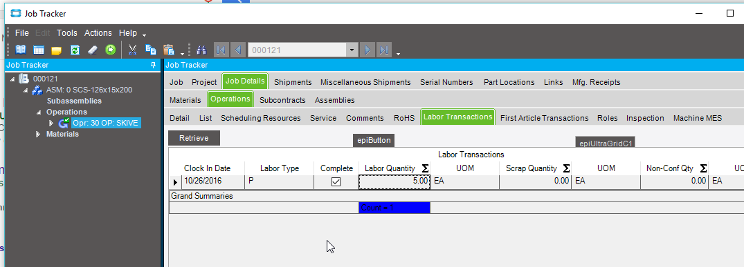

I’ve managed to get the color changed for the rows and header, but not the summaries.
Thanks guys, I’ll keep trying!
I think I got it
//Declare on Top of the Class
EpiUltraGrid ug;
//Inside Initialize Custom Code
ug = (EpiUltraGrid)csm.GetNativeControlReference("f45f4532-176c-4a87-8459-4cf95e66fd38");
ug.SummaryValueChanged += new Infragistics.Win.UltraWinGrid.SummaryValueChangedEventHandler(this.ug_SummaryValueChanged);
//Inside DestroyCustomCode
ug.SummaryValueChanged -= new Infragistics.Win.UltraWinGrid.SummaryValueChangedEventHandler(this.ug_SummaryValueChanged);
private void ug_SummaryValueChanged(object sender, Infragistics.Win.UltraWinGrid.SummaryValueChangedEventArgs args)
ug.Rows.SummaryValues[0].Appearance.BackColor = System.Drawing.Color.Blue;
