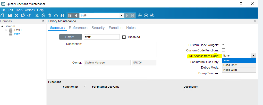

We can enable DB access in Epicor Functions.
It looks like you have more options. Maybe this is later version of epicor.
I am on 10.2.500.35
If I had access to Db then it would have been a quick/easy win… but I do not have it in (our) Epicor Functions.
