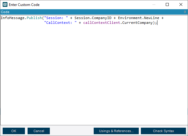

in customization:
string companyCurrent = string.Empty;
EpiDataView edvClientData = (EpiDataView)(oTrans.EpiDataViews["CallContextClientData"]);
companyCurrent = edvClientData.dataView[edvClientData.Row]["CurrentCompany"].ToString();

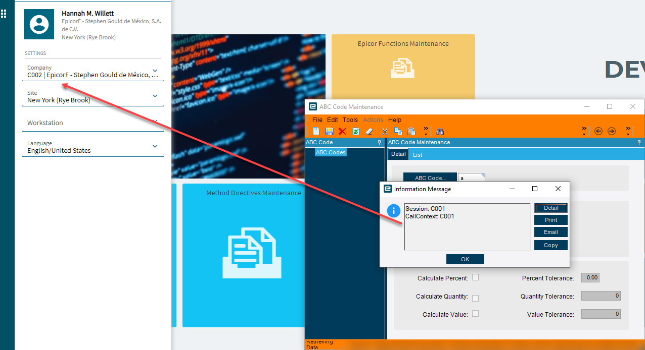

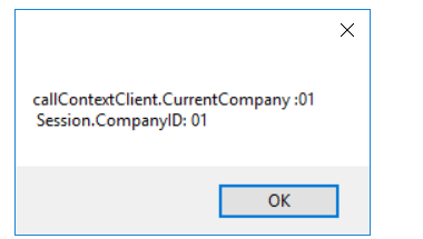

session = (Session)this.oTrans.Session;

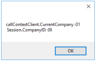

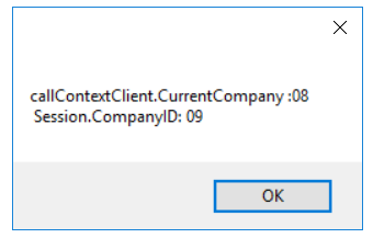

MessageBox.Show("callContextClient.CurrentCompany :" + companyCurrent +"\n Session.CompanyID: " + session.CompanyID.ToString());

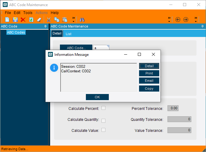

I checked again, maybe when the change company system doesn’t recognize the change, there will be a difference between the two variables
depending on where you initiate the session in the desktop

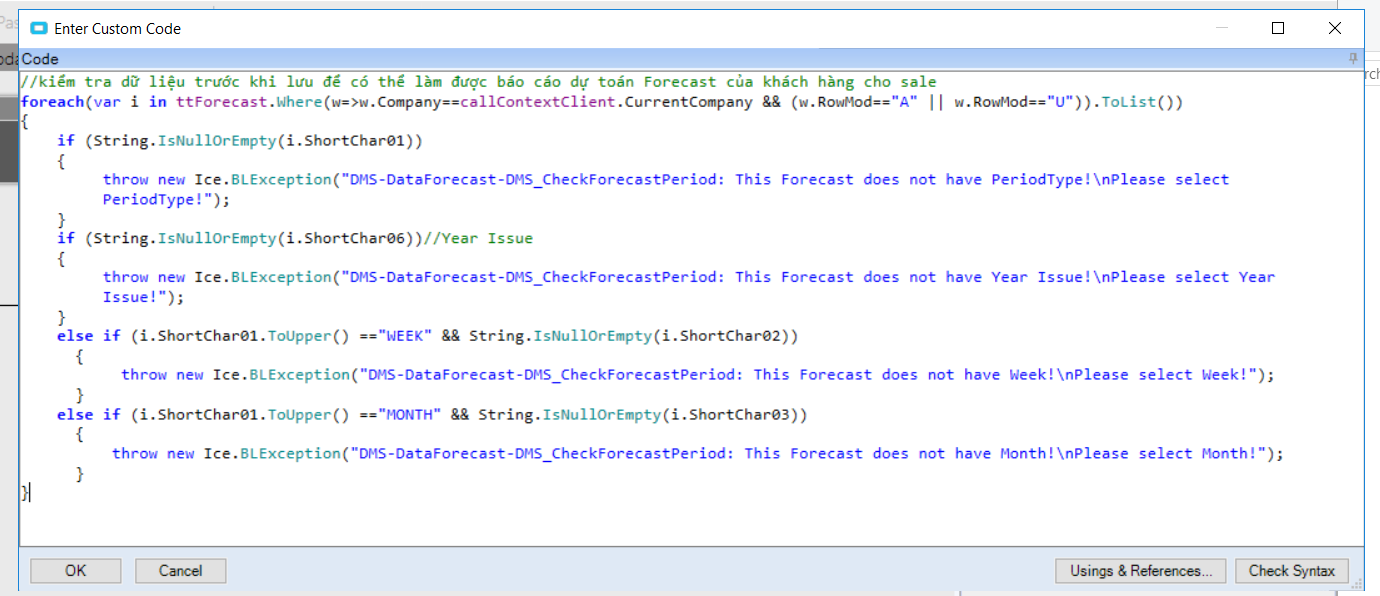

in BPM:
//kiểm tra dữ liệu trước khi lưu để có thể làm được báo cáo dự toán Forecast của khách hàng cho sale
foreach(var i in ttForecast.Where(w=>w.Company==callContextClient.CurrentCompany && (w.RowMod=="A" || w.RowMod=="U")).ToList())
if (String.IsNullOrEmpty(i.ShortChar01))
throw new Ice.BLException("DMS-DataForecast-DMS_CheckForecastPeriod: This Forecast does not have PeriodType!\nPlease select PeriodType!");
if (String.IsNullOrEmpty(i.ShortChar06))//Year Issue
throw new Ice.BLException("DMS-DataForecast-DMS_CheckForecastPeriod: This Forecast does not have Year Issue!\nPlease select Year Issue!");
else if (i.ShortChar01.ToUpper() =="WEEK" && String.IsNullOrEmpty(i.ShortChar02))
throw new Ice.BLException("DMS-DataForecast-DMS_CheckForecastPeriod: This Forecast does not have Week!\nPlease select Week!");
else if (i.ShortChar01.ToUpper() =="MONTH" && String.IsNullOrEmpty(i.ShortChar03))
throw new Ice.BLException("DMS-DataForecast-DMS_CheckForecastPeriod: This Forecast does not have Month!\nPlease select Month!");
