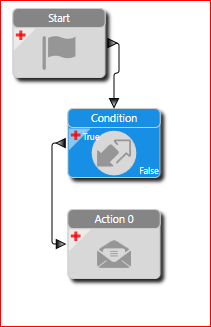

It would be on JobEntry.Update. This is for the Job Header, but you could add the other tables with Or and do them all in one directive.
E10 Job Email.bpm (18.4 KB)

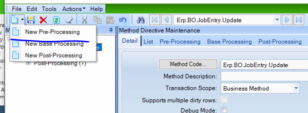

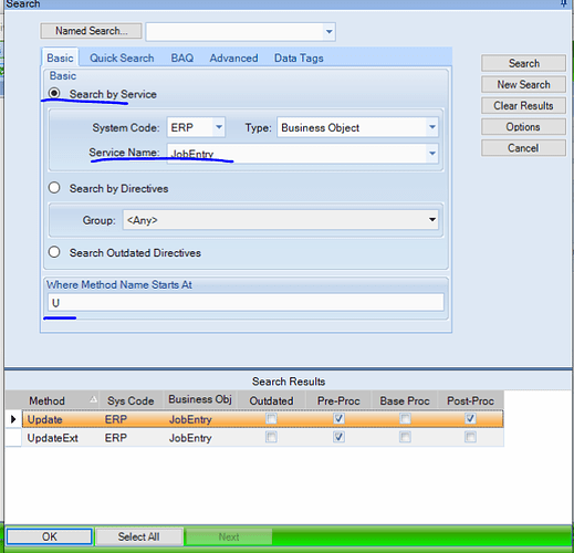

In method directives search and emter like below
Then you want to make a new preprocessing directive.
This will give you a blank directive to start from.
If you import mine then you will already have a preprocessing directive that you can change.
