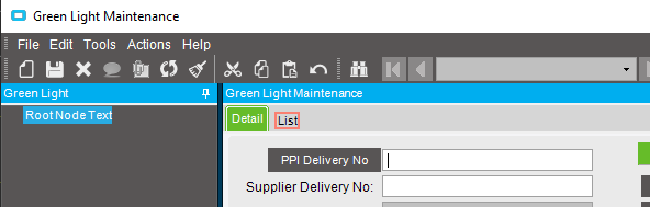

We created a Green Light screen but the changelog is not showing on the screen.
We already created BPM for the changelog. Kindly please help me with this.
What screen did you customize? If this is a UD table, are you sure you did not hide it in the code?
I use UD08. I didn’t hide in the code.
I also noticed it is not available in the UD Forms… You did indicate that your changelog is setup already…then in you could access the Ice.ChgLog table in a BAQ to view the results…

See this thread on how to add the Change Log button to any form with a simple customization.
