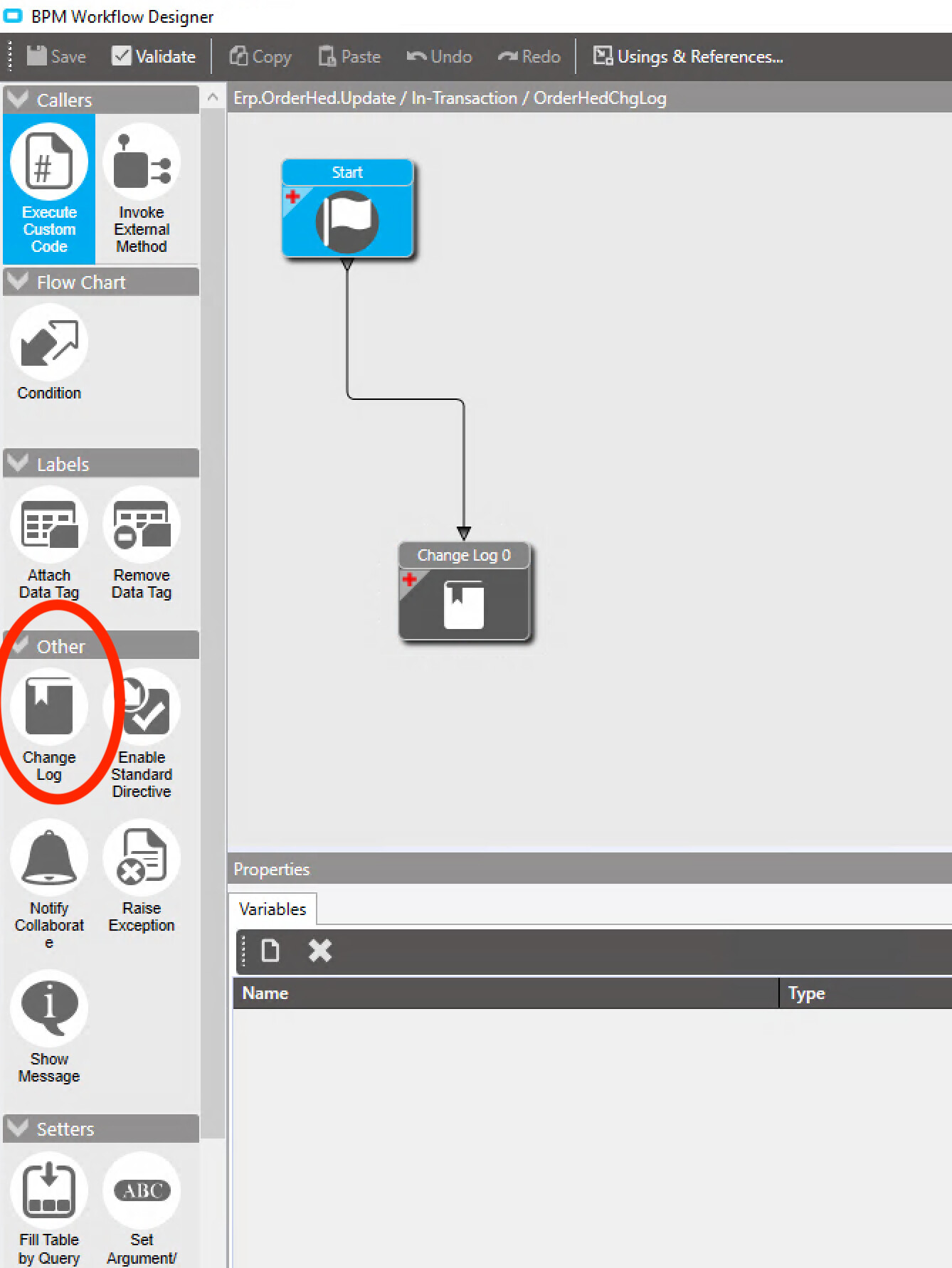

This is what the menu on the left looks like for most tables.

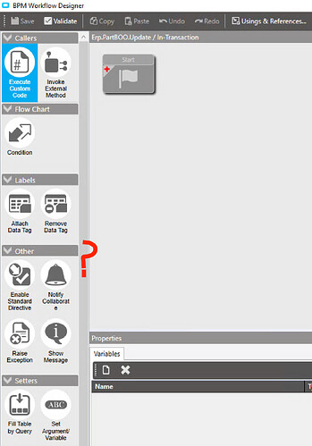

But on PartBOO and PartBOM, that option just isn’t there:
Why is that? Any way to enable ChangeLogs on PartBOO and PartBOM?

PartBom and PartOpr are two “special” tables… in theory nobody has access to change them individually, so there is no reason to have a change log (but I know… you want them).
All changes to PartMtl (BOM) and PartOpr (BOO) are actually done with ECOMtl and ECOOper… Not sure if those have traces on them either though.
I believe that this is one of those areas where you should probably submit an enhancement request.
